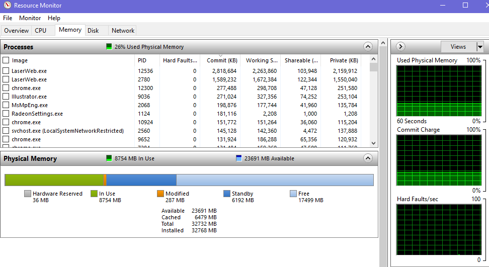

UI (win10 x64) gets noticeably sluggish with a complex and/or large raster job loaded. Looks like it runs two processes. Here’s a screenshot of its memory consumption with the job loaded. And here is the link to the gcode (35mb): https://drive.google.com/open?id=0B8jLpTsfTtT_aFo2UWt5a1R2RWs

It runs two main processes, UI and Comms layer. Raster jobs are generated on UI subprocess
Looks like complex/large gcode put a lot of pressure on the UI process. Might be worth exploring a separate UI for the simulator so that you can display a static image of the finished job after generation as a preview, of sorts. And then when you click Play on the simulator it pops a window (or whatever) that plays the simulation like a movie. That way the line by line gcode visualization doesn’t have to always stay resident in the app unless the user needs to review it.
