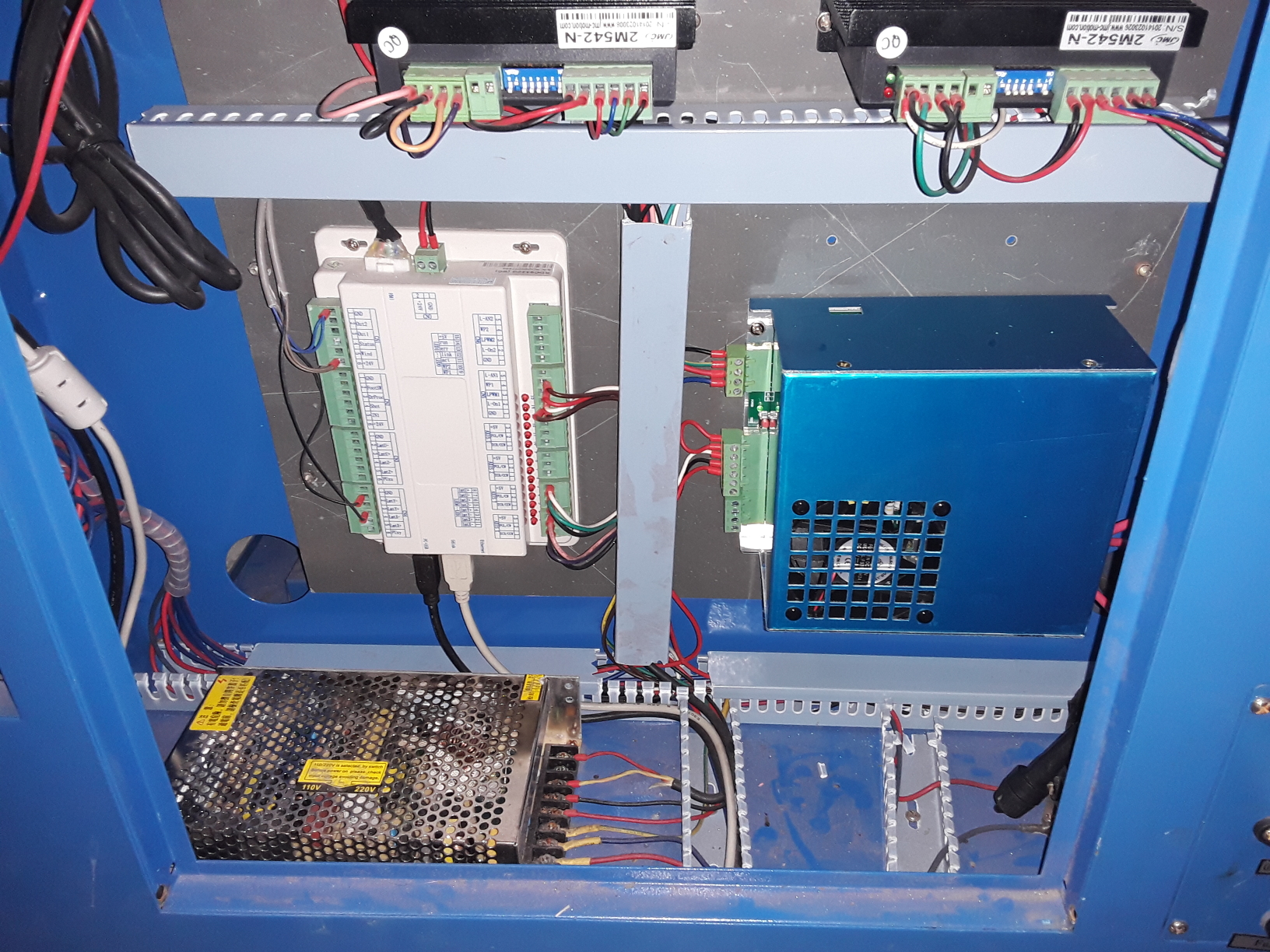

Hmmm…if the tube is significantly degraded you usually do not get a straight line in a mA vs % power. Typically it would plateau off before you get to 15mA tube current. What do you think @donkjr? Can you provide pictures of how your machine is wired?
