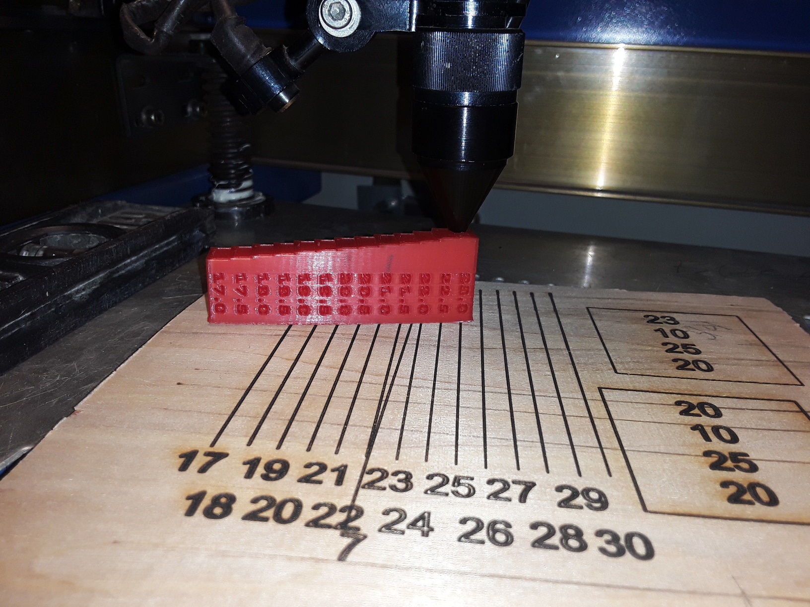

For the height, I did straight lines at each millimeter between 17mm and 30mm. This is measuring from the top of the wood to the bottom of the laser (but not to the lens). See attached image.

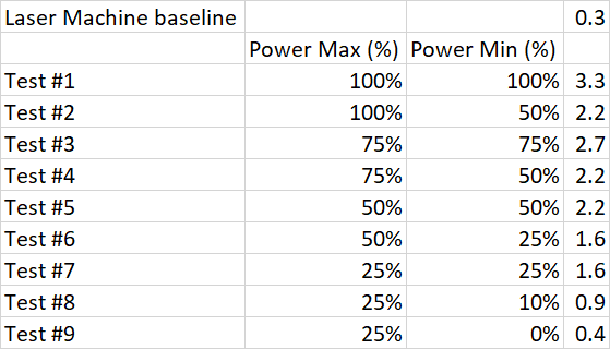

Here is what I got when using the Clamp meter with a setting of 200 ACA
OK, so how are you setting the power on your machine? I was assuming you had a digital control panel on your k40 but I’m confused by your use of max and min. @donkjr thoughts?
I don’t know were the clamp meter is placed and what type it is. I doubt a clamp meter will measure the tube current accurately.
Also do not understand min-max settings and the last columns data?
I advise installing a meter that can read (ma), in series with the tubes return (cathode). Then plot tube power setting vs tube current.

Do I understand your FL test correctly, you burned lines at different heights and looked for the thinest one?? It may be hard to find the right point with that method especially since the head is in differing x-y positions??
I suggest doing a conventional ramp test where the target is on an incline and one horizontal line is used to find the FL?

I have been using Lightburn and I was using it to control the speed and power. From my research, the ‘Max’ power is used for the majority of the time, but the ‘Min’ power is used in corners so the material doesn’t burn when the laser changes directions.
For the chart I made, I was using the power cord that goes into the entire unit, which includes the little LCD, external fan, gantry motors, and the C02 laser…. I used a clamp meter around the individual white power cord, the black and green cords were outside the clamp, I’m assuming the units are amps. But since I was measure a host of other items at the same time, I don’t think that it was a valid test. For comparison purposes, my wife’s hair dryer was 10.7 using the same clamp meter setting.

For the focal length test, originally I did the ramp test and saw where the line was the thinnest, it was somewhere around 24. To verify this, I did the lines at various heights and looked at the results. There was burning at the shorter distances and at the further distances it was more out of focus.

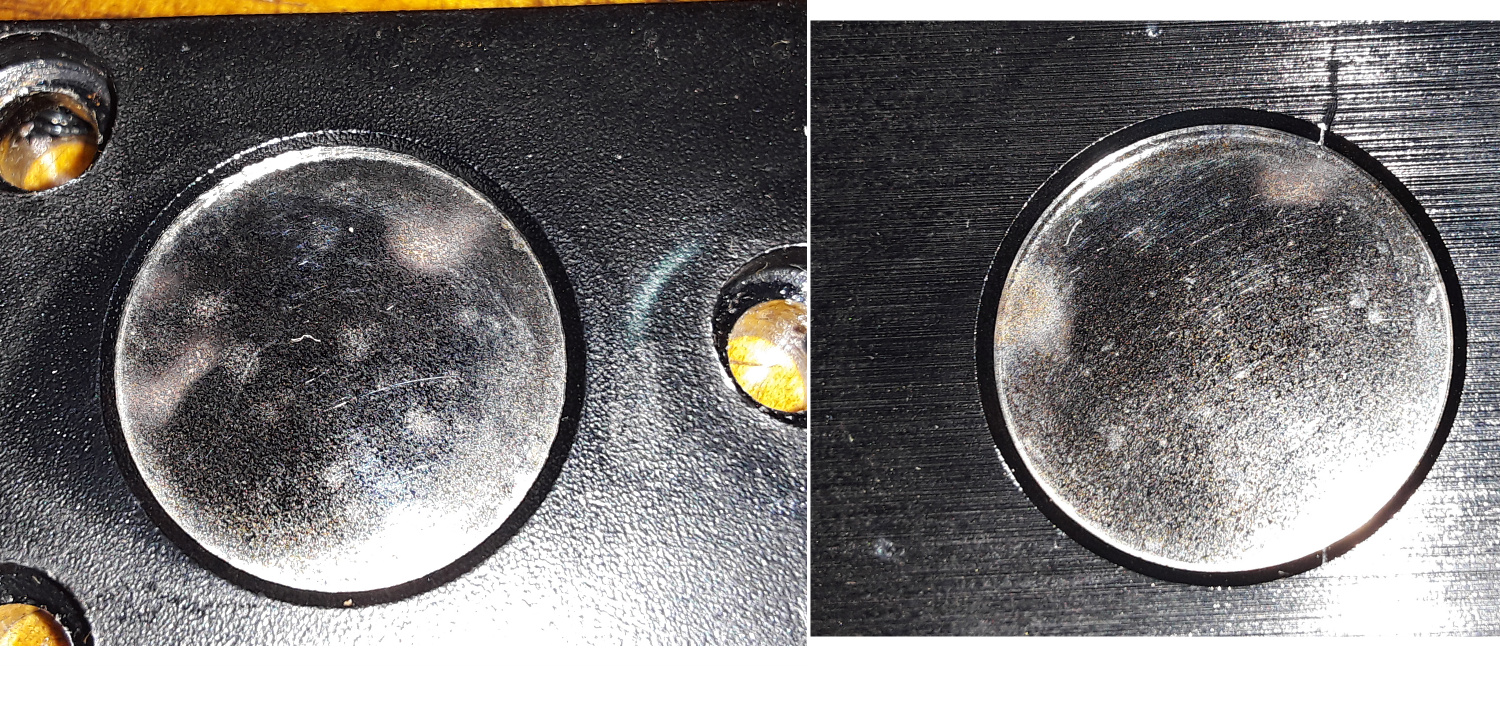

Here is the front and back of the focal lens. I didn’t see any burn marks, but there are some slight scratches on the concave side.

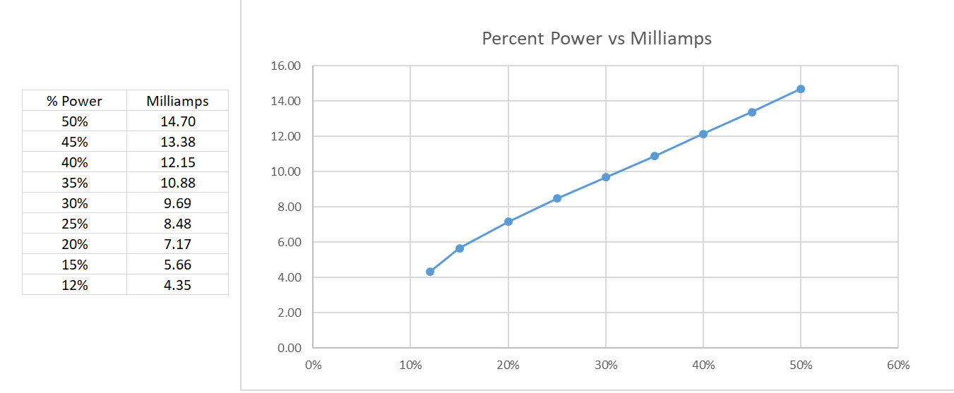

Here is what I got when I put my multimeter inline with the tube. My multimeter wouldn’t go any higher then 50% but the lower half is pretty much a straight line.
A clamp ammeter might not be super accurate for milliamps, but also and especially AC amps isn’t the right setting for measuring DC amps. I’m pretty sure there are clamp ammeters that don’t even have a DC amp range, though mine does. I don’t expect milliamp accuracy from my clamp ammeter.
The above chart I did with a multimeter using the mA setting. I put it inline between the tube and the power supply. So I think I finally got that part correct.
Ok those readings look fine. You would not want to run higher than 50%. 15mA is the recommended limit for best tube life. It deviates from linearity at the low end because you are getting close to the ionization threshold of the tube.
So as a reference, if everything is set up correctly, you should typically be able to cut through 1/8" wood with settings of around 8mA power and 10mm/s speed.

Yeah, those mirrors look toasted, may be your issue. Your lens is probably fine. Some light scratches won’t have much of an effect. For replacement mirrors and lens I would recommend Cohesion3d. The people who run it are long time members of this community and sell good products at reasonable prices.

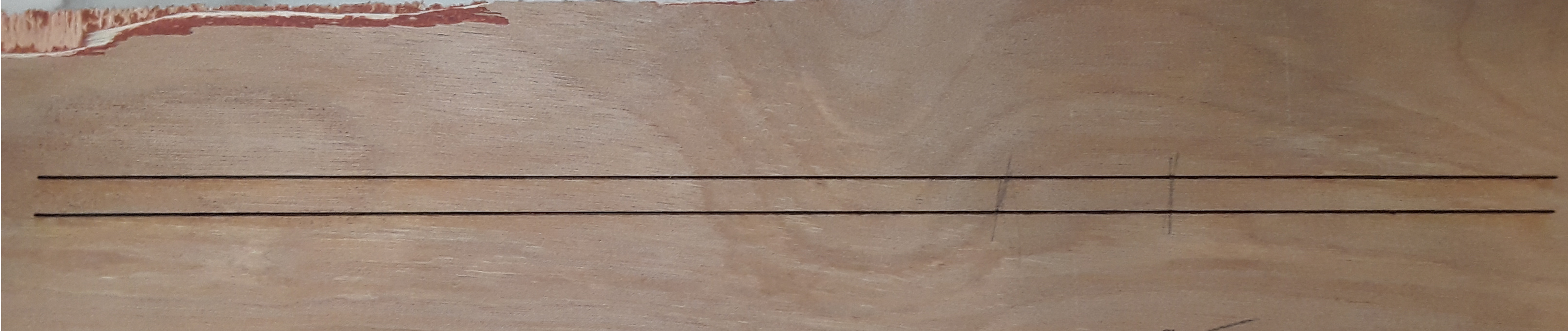

Below is the ramp test at 8mA power and 10mm/s speed that is .125 thick. I think it is most narrow where I drew the pencil marks, which is right around 50mm from the focus lens.
Even though the milliamps look correct, could the laser tube still be bad? Could there be an issue past where I measure it at the end of the tube?
