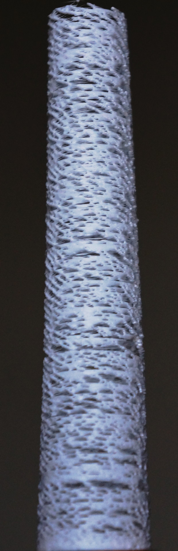

an interesting slicer fail…

It might not be a failure of the slicer. The model’s wall might just be too thin to reliably extrude for the given nozzle, and that is different between different plastics. There might be a special setting in Slic3r for thin walls but I don’t know.
Looks good to me lol
User error?
@Jeff_DeMaagd Sliced again worked fine. As it is a spiral print there is no wall it is just the surface of the object. And the preview was looking ok - not sure why there was this extreme under extrusion but i have seen this not the first time that the slicer (cura 2.3.1) produced a bad G-code. @Thomas_Sanladerer Nope!

Just found the reason for this, the filamentdiameter was set to 2.85 instead of 1.75. As i didn’t changed this somehow the values from the generic materials (which are at 2.85 ) were transfered to that profile. That is quite funny as these values didn’t change at all even when i intentionally change the material — where these should change. However, just downloading Cura 2.4 - hoping the material handling has improved …
@Ulrich_Baer Well at least you now know a quick and dirty way of producing Voronoi prints
@Mark_Wheadon haha, but as PET is very “stringy” you could indeed produce a lightweigth Object - maybe this would be good for supports or an narrow but light infill. Just a few days ago @Bjorn_Marl showed me a failed ~ 60% infill TPU print which resulted in a super soft Object, like a sponge or foam - probably caused by underextusion or temp.
