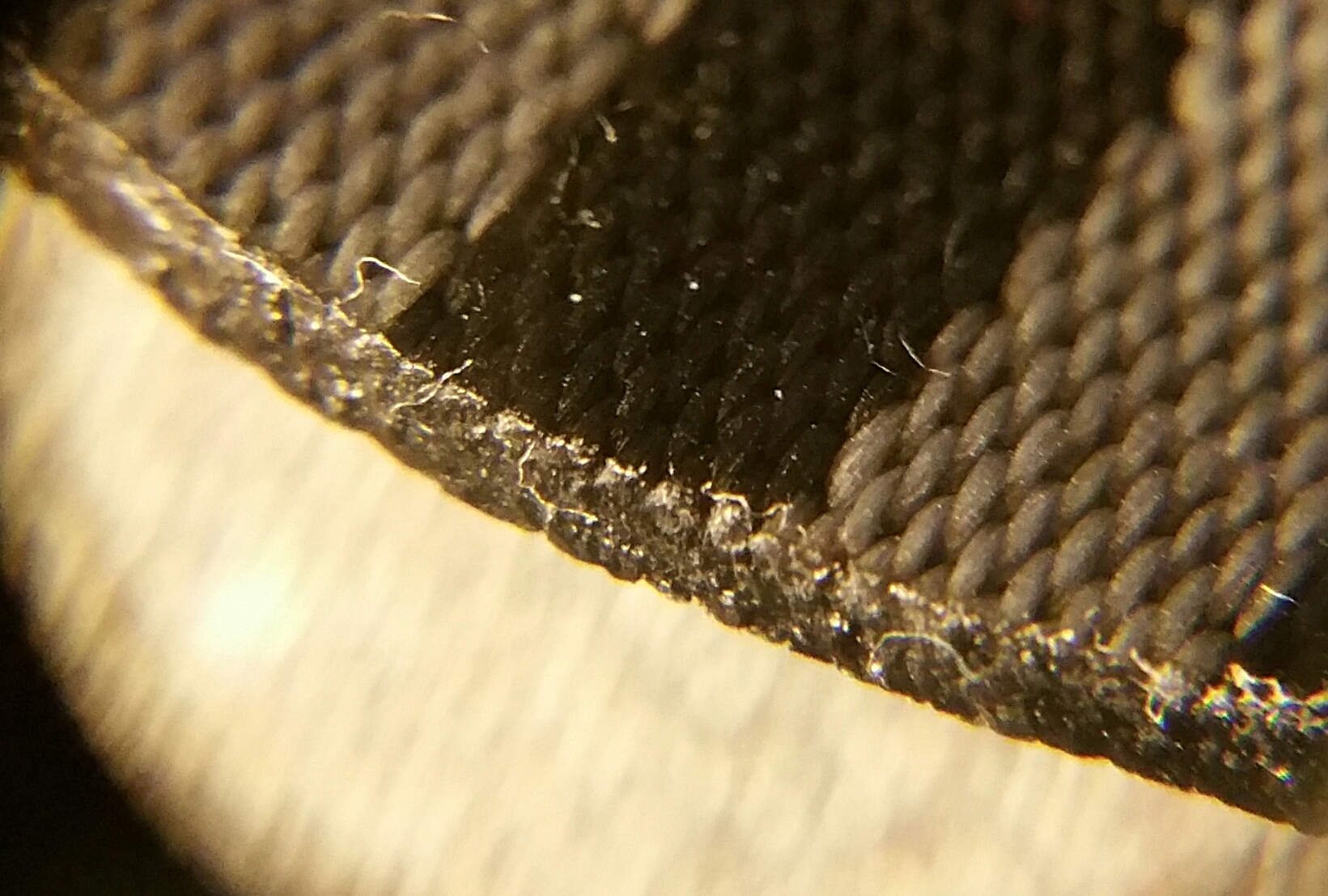

Maybe can someone try to punch holes and make some cuts on some nylon/polyester webbing, if you have some, that you don’t need?
I want to be able to produce holes and cut like on my pictures. Do you think it is possible with this machine?

It is not a question whether it can cut or not. The question is whether is would seal with the same quality, and whether it will build up unwanted melted, and thick ridge/edge or not.
To add, it is also a question whether the melting, edge build up can be controlled properly by cutting speed, power, power of air assist or not?
I tried it out on a nylon belt almost 3mm thick and it cut without melting perfectly…a few squares and a few 2mm holes.
