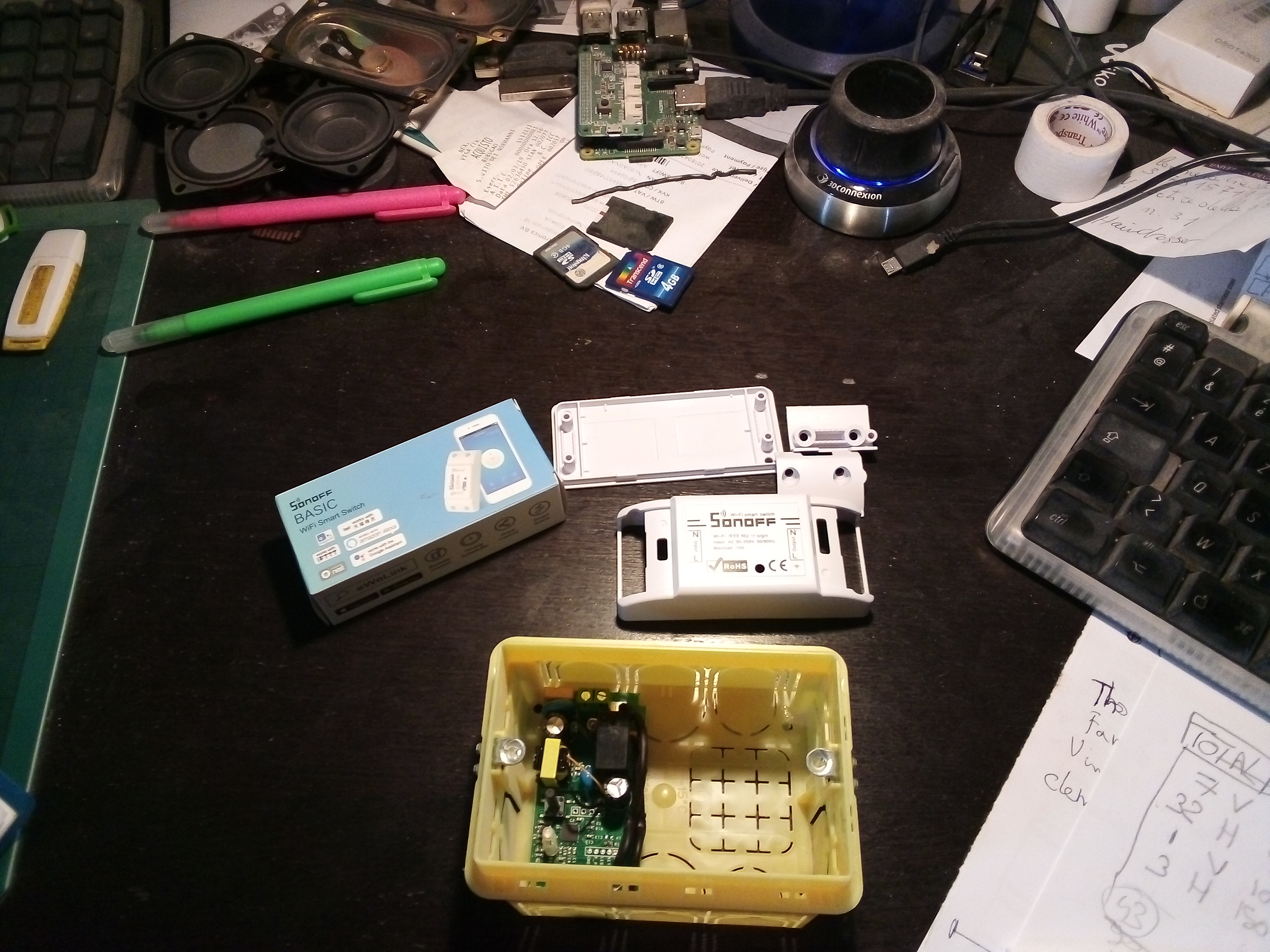

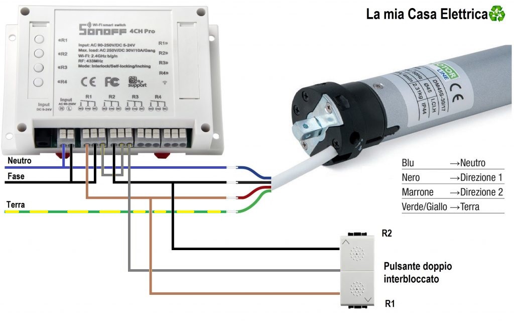

OK I found a solution witch also allow me to keep the push buttons, the sonoff 4ch describe there :
https://lamiacasaelettrica.com/sonoff-tapparelle/
How do you plan to control the motors with this?
Configure relays in an polarity reversing format?
simple connection as per following design.
the 4ch pro is compatible with tasmota, Mqtt will be the way.
my problem is the size of 4ch pro it don’t fit the wall box behind the push button.
if only it was a 2CH pro …that would have been fantastic.
Look like the Shelly 2.5 is a far better option as the built in server offer the possibility of setting a time for motor up/down. Sonoff 4ch don’t and have a max value that could be too short for your shutter.
https://shelly.cloud/shelly-25-wifi-smart-relay-roller-shutter-home-automation/
It is far smaller fit in wall box (Sonoff need to be in the shutter roller box and waste 2ch).

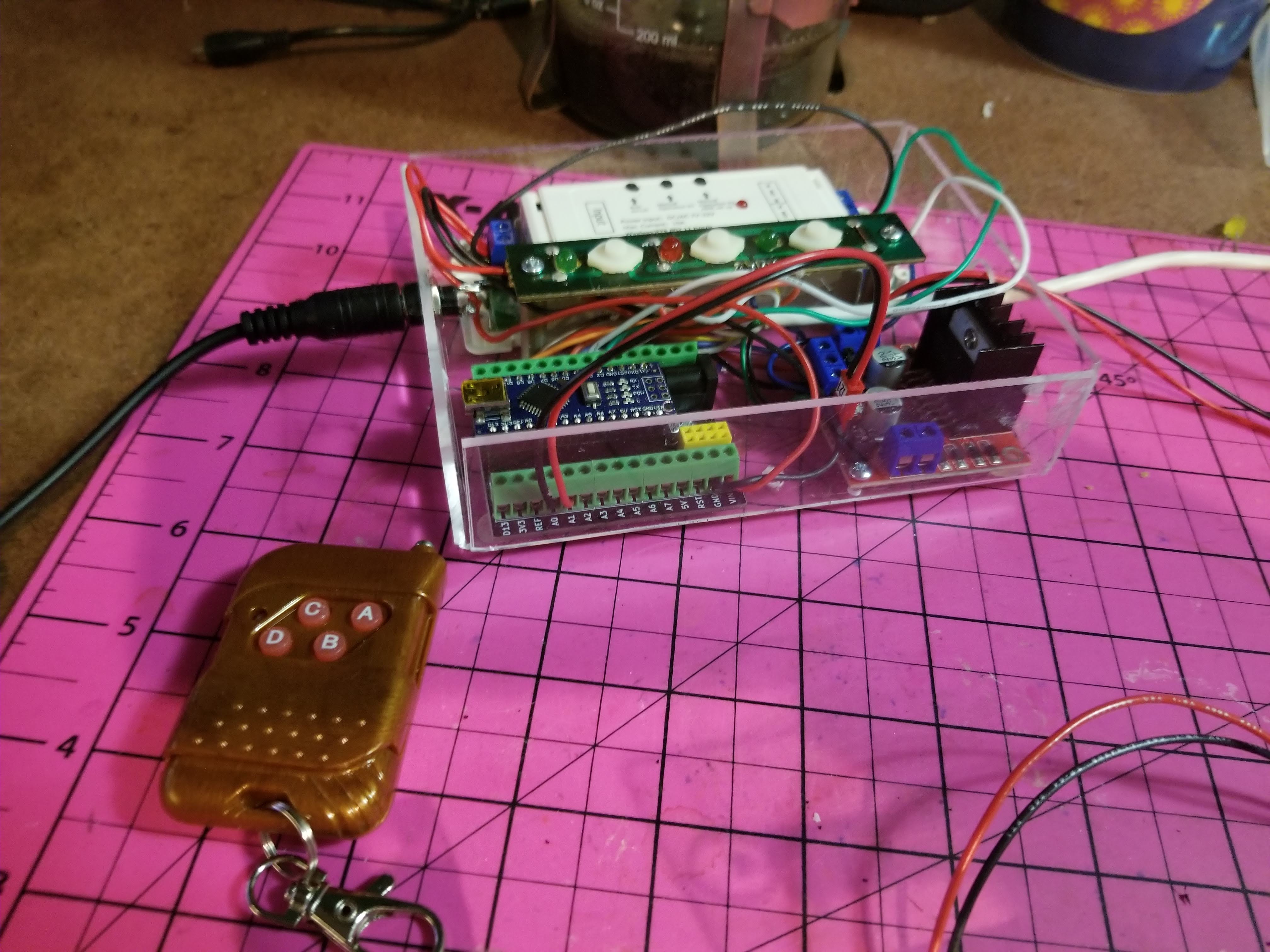

Interestingly, I just started a project to automate cheap roller shades.
My plan is to modify the cheap shades from big box stores to interface with a gear motor and brackets much like this inspiring video shows: https://youtu.be/2bWeKEtdMFA
My home is using Google Assistant so I wanted to stick with the app I use, eWelink.

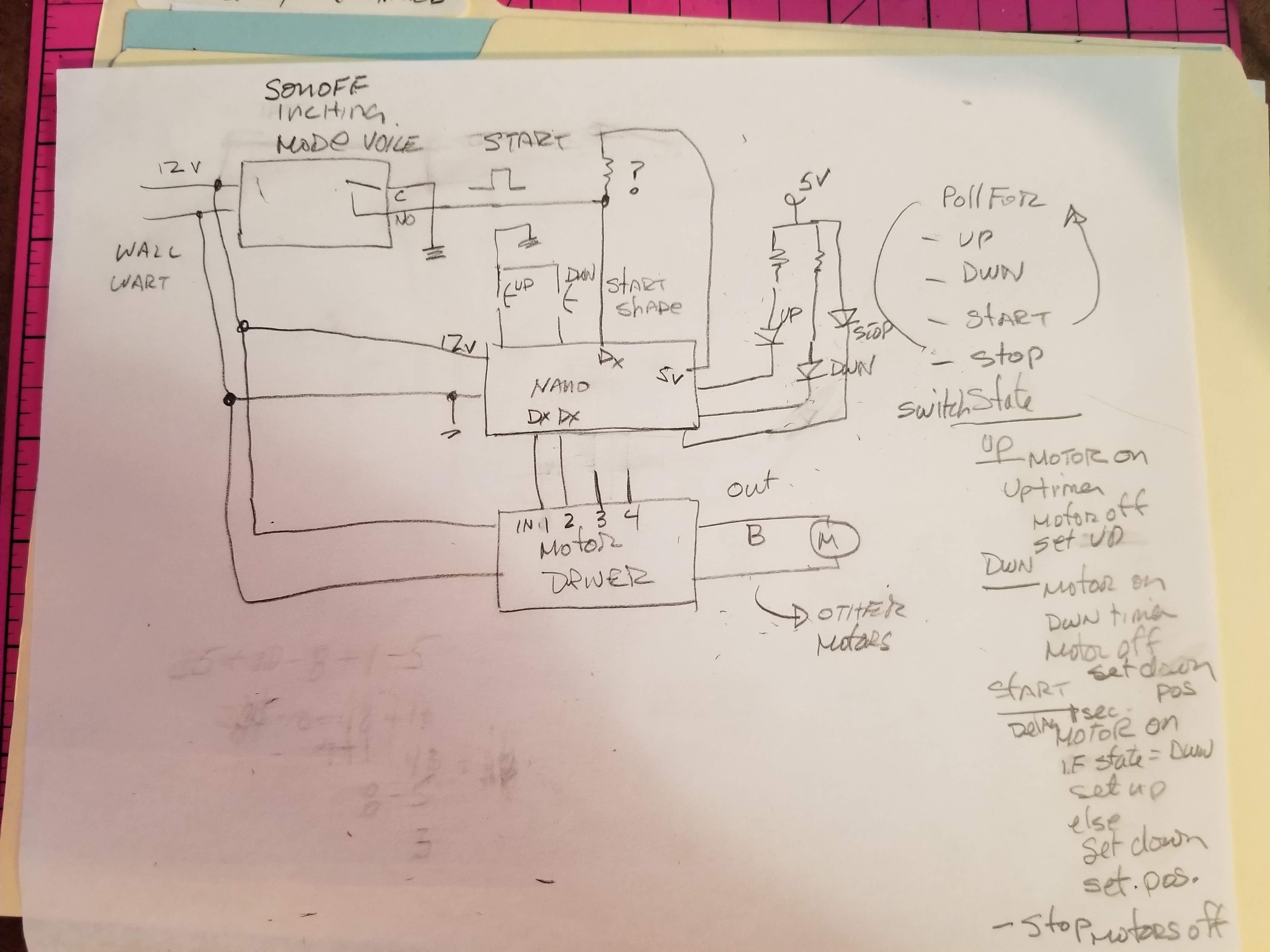

My plan is to use a Sonoff compatible relay in the “inching” mode, i.e. it outputs a pulse.
That relay will connect to a Nano that is connected to a motor controller then the gear motor which is attached to a modified shade.
Attached are some pictures including my circuit scribbling and the prototype electronics. Also, you can see the start of my mod to the shades.
I am going to start by simply turning the shade motor on and off for a period of time in the direction opposite of its position which is stored in non-vol memory. Not closed loop but in my application if the shade does not stop in exactly the same position that will be ok.
If that does not work I am going to try optical end-stops that read punched holes in the shades.
The shades can be controlled from Google Assistant, a 433mhz remote or local at the controller.
This design probably has one more u-processor than it needs but I did not want to write my own interface & app to Google Assistant. The sonoff compatible device I am using is 2 channel and I only need one. The amazon add suggested you could control a shade motor with this two-channel device. You can command a motor forward or reverse but there is no STOP state …huh!
All these parts are pretty cheap and on amazon. The one controller is expected to drive 4 shade motors. Depending on the torque required I may have to add 1 more driver. More info is available if it’s useful.

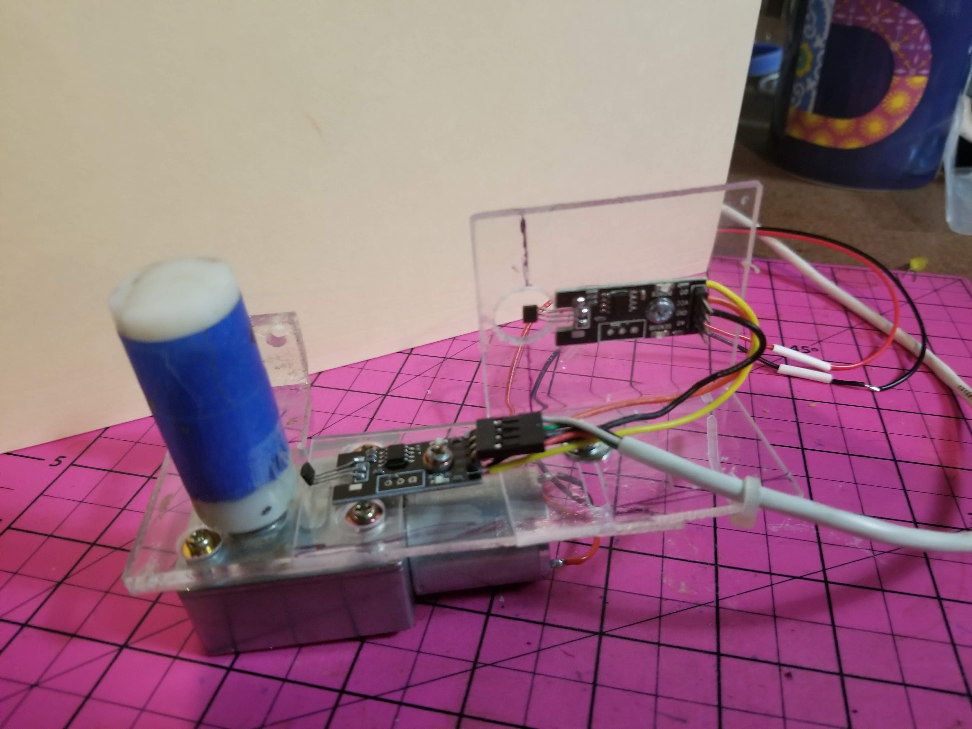

I am afraid you will not do without the end of stroke switches. Counting time is ok for crude positioning, but you will need an accurate control at least at the top and maybe also at the bottom of the motion.
You may omit the bottom sensor, at the expense of unaccurate lower end of stroke using time counting.
Optical sensors might not be the best choice near a window because of ambient light. If you do not want to use a microswitch, a good choice would be a hall effect sensor and a small magnet attached to the bottom of the curtain. An example of such a sensor is found here.
A good placement of the magnet is necessary for a reliable operation, but it is not difficult to achieve.
Yet another solution would be a reed switch and a magnet. Both are very cheap.
Thanks, all good things to consider:
The optical sensors are IR and up to now other than extremely strong and directed light I have not had trouble with ambient. That said the hall effect switch is likely a better idea.
My shades are installed under a valance and can afford to stop with an accuracy of 1-3 inches at the top and on the down side they only have to open to a position below the horizon of the couch so that error can be large.
Both up and down positions have a lot of tolerance and will still be out of sight.
Due to the high gear ratio motor I am expecting it to stop pretty quickly and the gear train to provide a lot of holding friction. In addition the end mounts are being replaced with bearing to help with smooth and more repeatable operation.

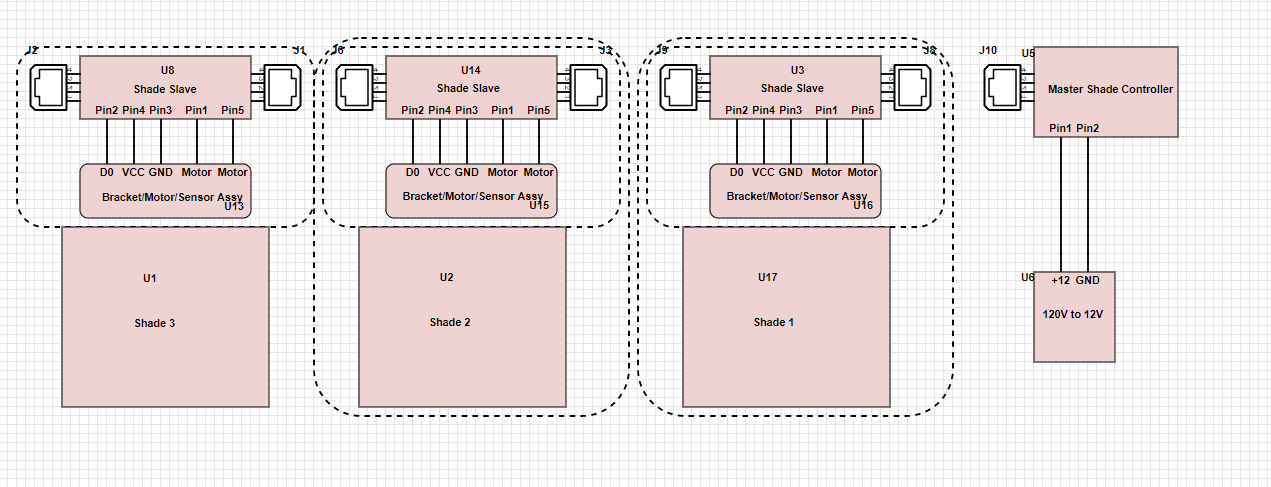

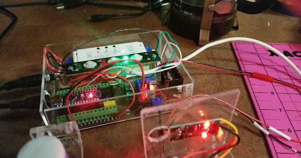

Update on the shade project:
Control schema:
Time-based control worked … kinda… not!
Things I found out:
Although I still think it is possible, it is not practical, two many variables made this complicated to control and multiple pots would be needed to make it useable.
My statistical model told me I could be off as much as 11", although I doubt this would ever happen.
The case where the power goes off in the middle of the shades movement dictated a “Home” sensor. See details on using EEPROM**

I have added 2 sensors (yah we all knew it would come to this):
  • Shaft sensor that counts revolutions
    – A small magnet inserted in the shade tube adapter and a hall effect sensor.
  • A home sensor that detects the up (home) position of the shade.
    – A magnet on the backside of the shade positioned so that the proper amount of shade is left hanging when in the up position. *** Thanks @Phono
  • Added a 2 channel Google Assistant wifi control that also supports a 433mhz FOB.
    – One channel commands up and the other down.
    – The wifi connected app will not allow me to change the name of the channel so saying " Hey Google, Shade Socket 1 ON" for going up … is kinda cheezy.
    – The FOB next to the TV chair may be the main means of controlling the shades!
Meeting the boss’s main objection visible wiring: the new sensors have not exposed the wiring much as its all still hidden up under the Valance.

  • Controlling multiple shades in sync will require a master-slave kind of setup. The original design accounts for this. Build modular motor drivers that mount on bracket?
