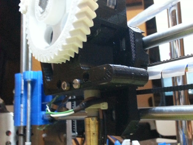

I decided to go with this modified wades extruder:

I’ve been trying to redesign the Greg’s Wade extruder reloaded so the motor is level like Misan’s design here (plus a couple of changes). The slanted motor drives me absolutely nuts! :grin:
I thought the slanted motor made it so you could access the last stepper screw through the big gear instead of having to take the big gear off. Of course that depends on the angle of the stepper with respect to the hobbed bolt as well.
I know that’s the reason. But it can be accomplished as well by moving the motor upward without slanting it, which Misan’s design proves. I won’t be using his because as my X axis is horizontal rather than vertical, I don’t need the motor to be so much higher.
Here’s what I was talking about: https://plus.google.com/117324667497119008450/posts/bN2bRrpfNKq
Gotcha, hard to see without the gear. Nice comparison. That’s why I had a CYA in there “Of course that depends on the angle of the stepper with respect to the hobbed bolt as well.” :]
