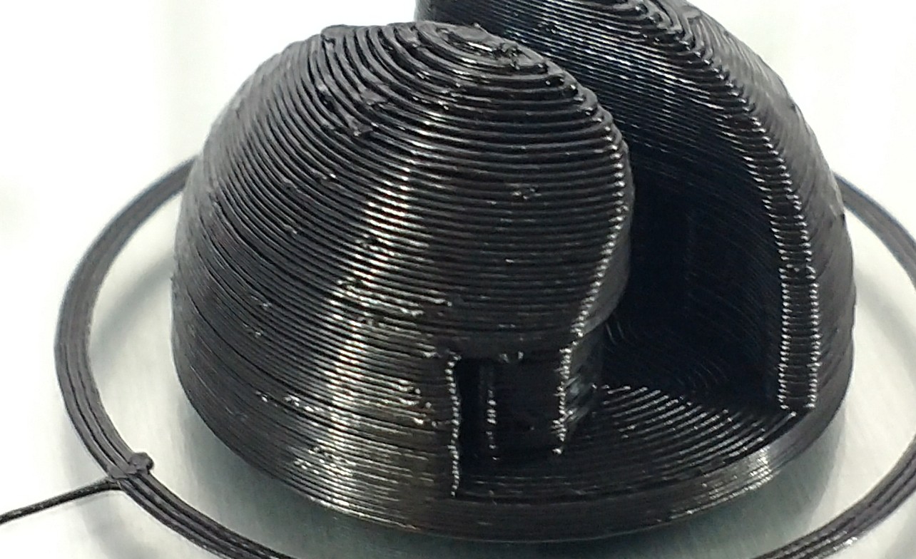

Can anyone help with my blobing issue?
For a while now I’ve been trying to figure out why I keep getting these blobs on my prints and I finally figured out the reason behind it but I’m not quite sure how to fix is. Basically the printer primes, moves and prints, stops, retracts and then moves again, like it should. However, between the stop and retract parts, that’s where the blob comes in. It prints just fine but in the split second after it stops and before it retracts, it’s leaving behind these little blobs. I have already turned coasting on and the problem still persists. I’m using PLA+ material. The manufacturer suggests 205c-215c for printing but I’m currently running at 200c (according to the printer). Any other ideas on how to fix this? Is there an option (I use Cura) to make the coasting start sooner? Will running it too cold cause this issue? It seems to print fine other than these blobing issues. Any help is appreciated.

@Julien_Dodokal yeah but on a round object, there aren’t any corners to hide the blobs in. This was printed on “random”. Maybe I’ll try a different setting and see if it’s any different.
@Dave_Benson increasing retraction probably won’t help as it’s blobing BEFORE it retracts. And no, it’s not accumulating anything on the nozzel. I don’t think it’s over extruding but that’s a possibility. Maybe there is just too much pressure at the nozzel. I’ve also wondered that maybe it’s happening because the temp is too low. If it’s creating too much pressure in there it could be because it’s too hard to push the plastic out. Maybe raising the temp could help.

Ok so I think I figured out my issue! I increased the temperature. Why? Because the filament was still oozing out even though coasting was on. This led me to believe that there was too much pressure in the nozzel when it stopped printing. I had an idea that increasing the temperature would soften the plastic slightly and allow it to flow more freely. Once I combined having less pressure with the coasting feature, it sure cleared up!
https://lh3.googleusercontent.com/jRX2suLnbFR2lxBP1xZlKrEOxtmN1DyvvodNEFqqICakWGBLVqvkPlMSC0dRRH5P0cSZcNKFNgo
@Cristian_Nicola I increased it to 205c instead of the 200c I had it at. I tried 210 but it was getting a little droopy.

@PrintinAddiction well like I said above, the blob is happening BEFORE it’s retracting. There was a brief period of time after the move and before it retracts where the blob was coming from. Retracting more wasn’t fixing the issue and I already tried that.
@Kevin_Danger_Powers So you are getting the blob while it’s moving in the X or Y? That is surprising that your building up that much pressure and retraction doesn’t help. But it seems like you found the culprit, and fixed it. Didn’t mean to reiterate what was already did, but sometimes I find that I thought I had checked something thoroughly but missed a small part or step.

@PrintinAddiction no, not while it’s moving. It’s between printing and retracting. So it prints a line, stops, retracts and then moves. There is a brief pause between stopping and retracting. THAT’S when I was getting the blob. Apparently there is a very short delay after it stops and before it retracts. Because it sits there for fractions of a second before retracting, it was still under pressure and would leave a blob.
