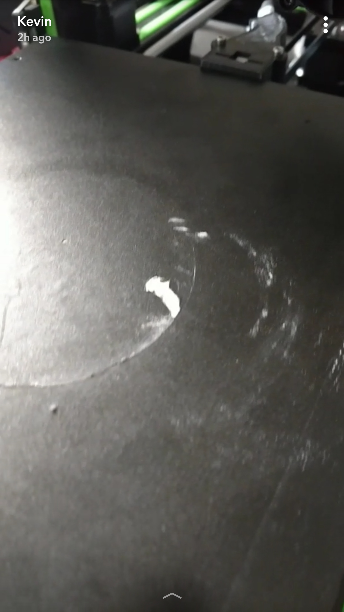

Update: Ok so I finally got the part off.

Ok so I finally got the part off. I made the bed cold with ice packs and bought a different razor that came with a handle. I slowly worked my way around the part but as it came up, it ripped a chunk out of the surface… So the part’s off and looks great but the surface on my bed is ruined… Guess I’ll go back to glass. I liked how it worked on my old printer anyway.
@Kevin_Danger_Powers Seriously – it’s all about how close your first layer is. Try with what remains of your surface: print something smallish with a brim and set the height so you can see the distinct rings of the brim and it’ll come off much too easily afterwards or perhaps mid print. Print something so there is absolutely no way of seeing the individual perimeters in the brim and the inside edge of the brim curls up slightly as it’s printing (i.e. the head is dangerously close to the bed) and it’ll be stuck too well. In between is the sweet spot.
@Mark_Wheadon I guess I’m just use to using glass. When it cools, my parts always just popped off (or required little force). This new material is just different I guess. Oh well, it’s junk now I guess. I’ll probably just get another sheet of glass. It seemed to be the easiest to use. Unless you have some other kind of magic material I haven’t heard of…
