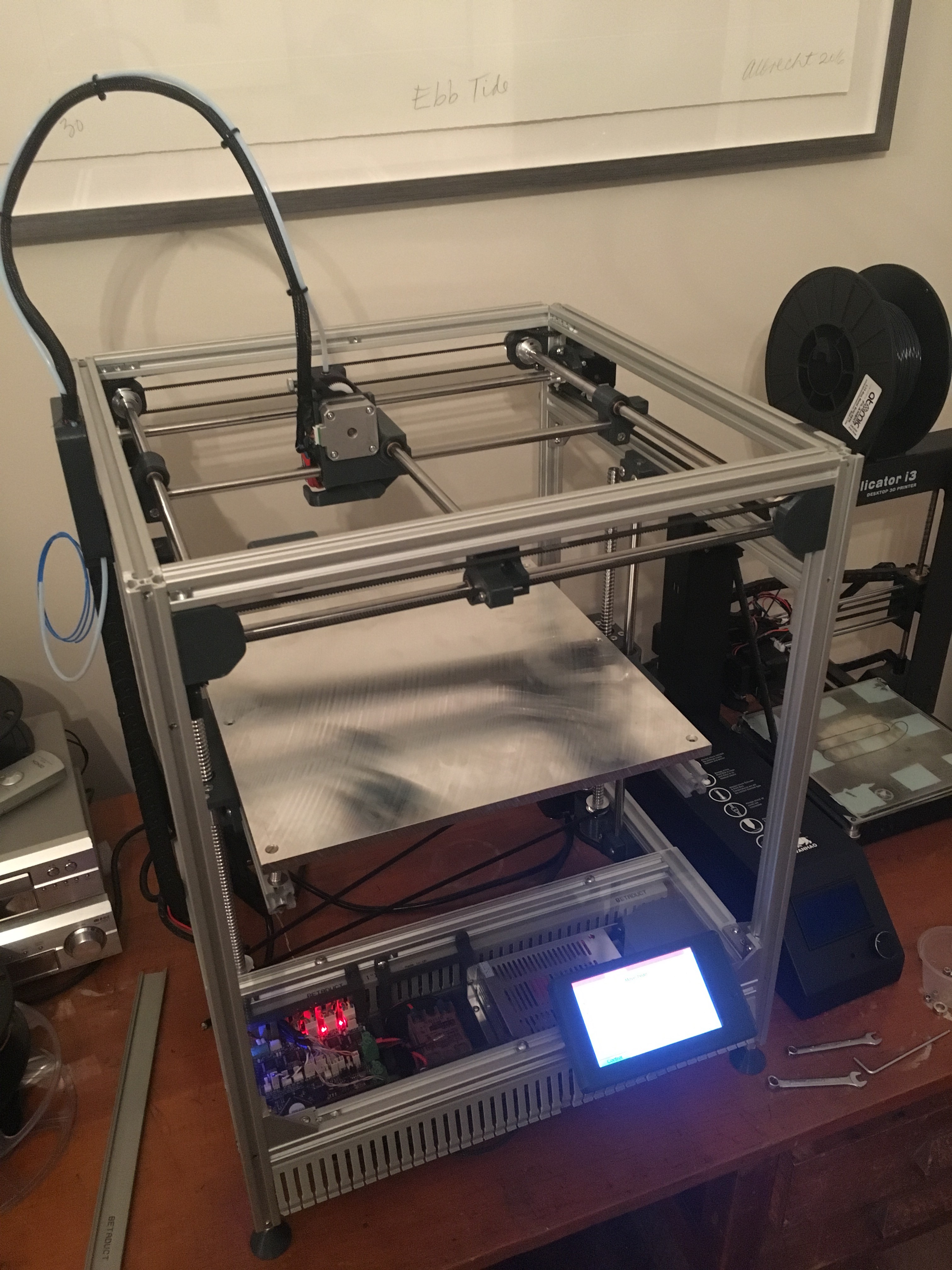

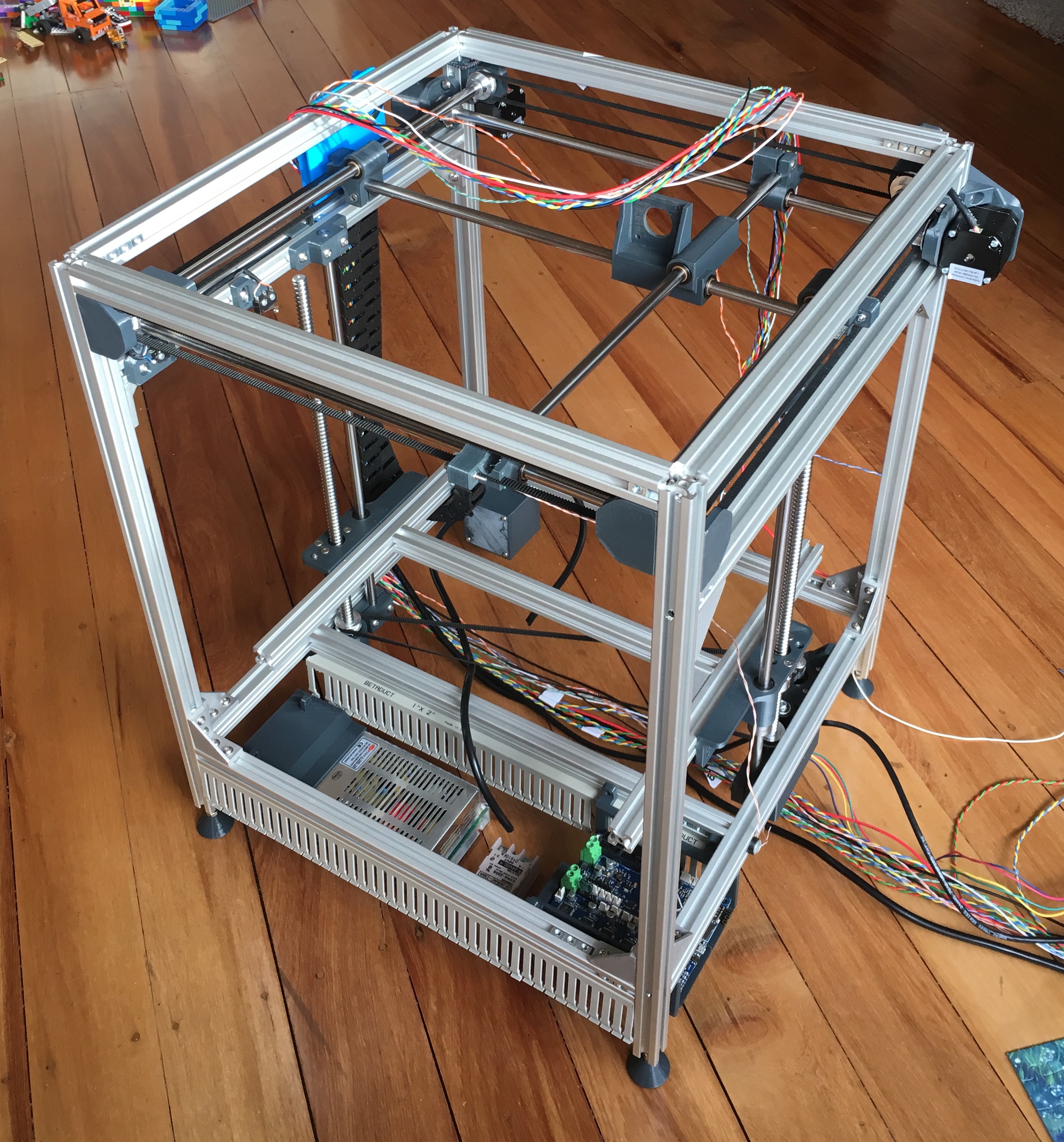

Update on my build. Slowly working out where everything goes and hopefully hard wiring everything shortly. End stops in and working. Have had the z axis moving. Got a replacement screw from Golmart - straight as an arrow but it has a little rough spot which is a bit disappointing. Am going to have mains heated bed - got a keenovo heater for that. 10mm cast Ali plate (worried about the weight) - going to try 3 point levelling. Also got a panel due. A few more mounting parts to finish designing/ print and I’ll take the bond tech off my wanhao and put it on this one. Hopefully post a break in vid in a week or so!

Hi Dennis, getting there thanks. Extruder and hot end in. Wiring is complete and have been running break in code. This afternoon I’ve been working on mounting the bed (3points) and should have that in tonight. My PEI isn’t here yet and I’ll wire up the bed heater (220v)once everything else is done. I’ll post a picture tonight if I get the bed in. Cheers
