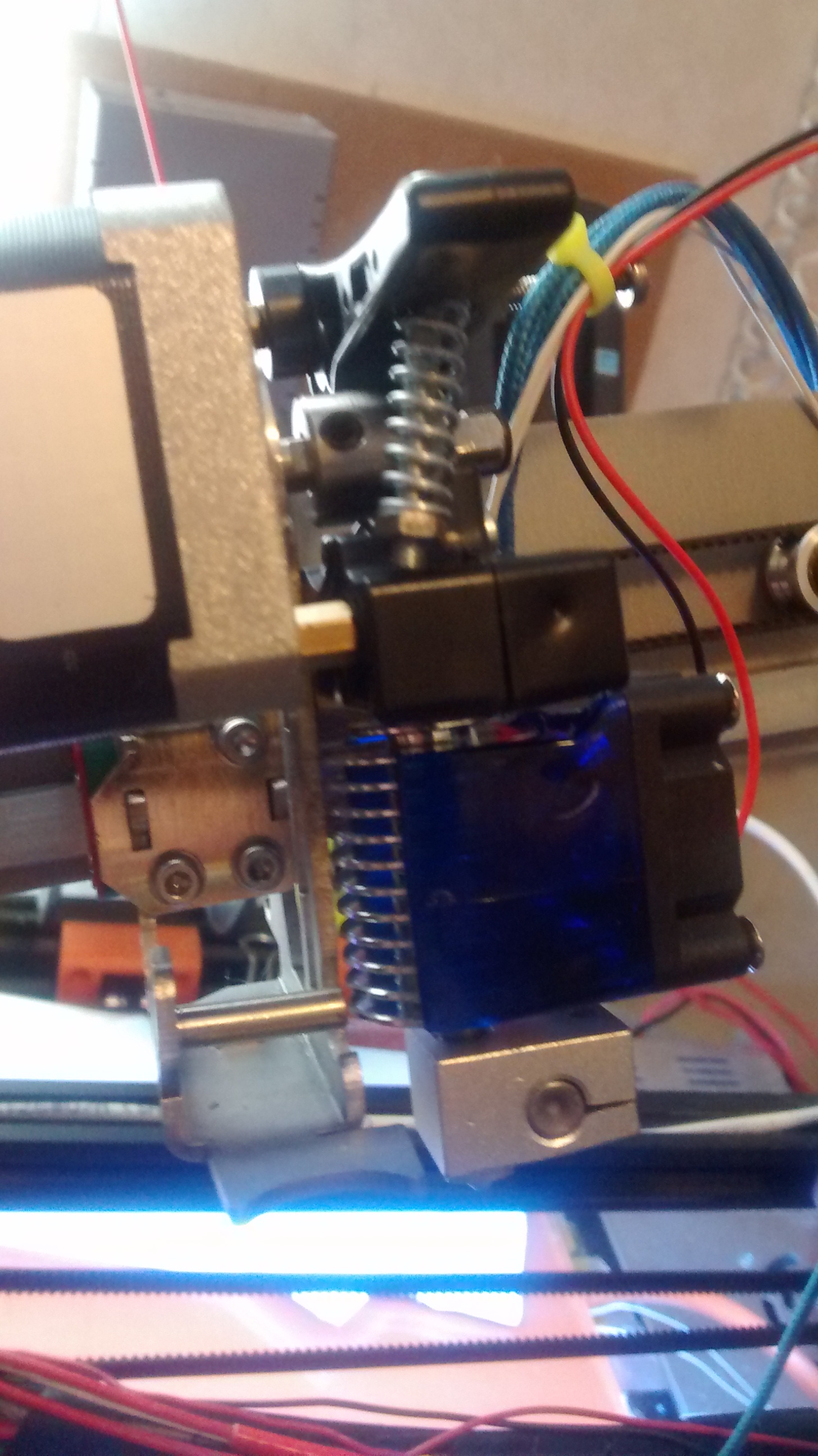

Update on the hacked cubify cube got the bed support machined (enroute),
Update on the hacked cubify cube got the bed support machined (enroute), added a printrbot 6x6 heated bed and the plastics extruder, dropped the Buddha it wasn’t going to work with this setup added a E3d clone I had laying here for direct drive extrusion. Been playing around with the firmware put repertier in it trying to learn some of the settings, since all my other printers run a form of marlin.
