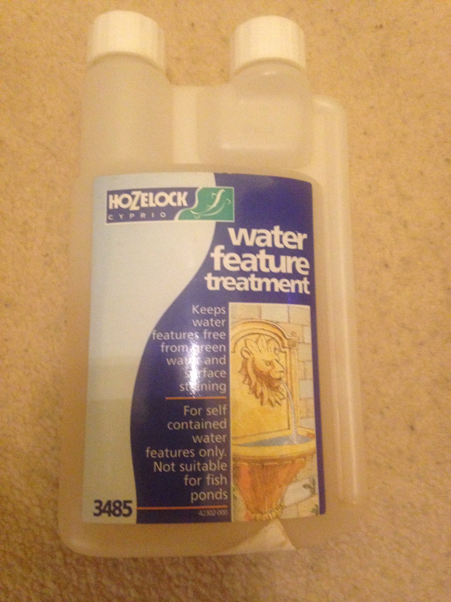

@donkjr interesting reading Don, I started to use Standard auto antifreeze at first, noticed the “tracking” sound on the tube at times. Investigated on here and since your thread. Hanged it to deionised water with anti algicide. Ever heard that tracking sound since. Pic below of what I used, quite good as SWMBO already has it in stock for the water features we have in the garden. Not had any algae growing yet so time will tell. Might help UK users to identify what they could use. Not tested the conductivity it can only guess that it works as I have not had the cracking sound since used it.

@E_Caswell can you tell us what is in that water treatment i.e take a picture of the labels ingredients?

@donkjr looked on the bottle and doesn’t give what it actually contains. However link here to their website. Looking around it seems that it is a fruit based material. However I can’t really help much more than that.
http://www.hozelock.com/our-products/aquatics/pond-care-aquatics/pond-treatments/water-feature-treatment/#full-details

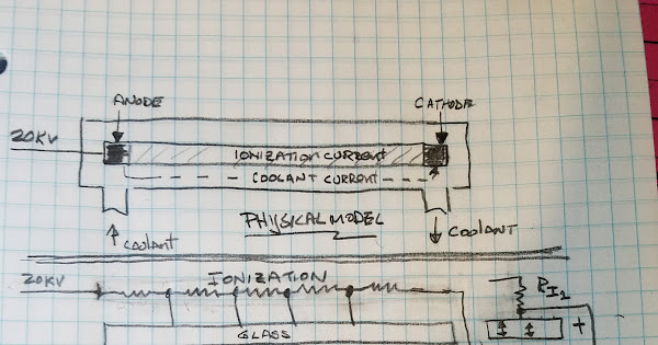

Since you planted this notion in my tiny mind (thanks for that distraction btw :slight_smile: I have been tinkering with a model of this system as shown in this sketch. Although I am sure this is not correct it is how I like to break the problem down (pun unintended) and start a discussion, sometimes just with myself…
I have been thinking of setting up a dead tube with a coolant source and then seeing if I can get current flow through the coolant from a LPS at different conductivities. That is why I am looking for a dead tube.
One of the things that I noticed on mine is there seemed to be a concentration at the anode when I got the crackling sound like perhaps there is a electrically weak (thin) dielectric area at the anode end. And perhaps if the coolant is two close to ground potential areas of the tube simply breakdown under such HV. I don’t know how thick the glass is.

@E_Caswell thanks I guess in the UK vendors are not required to list ingredients or have a Material Safety Data Sheet?

@donkjr @oliver_jackson what I have noticed with mine is that the one I have used in not aquarium safe and is. It recommended to use in them. It is a water feature only additive.
I understand that feature type is much greater concentration mix. Thought it was worth pointing out.
