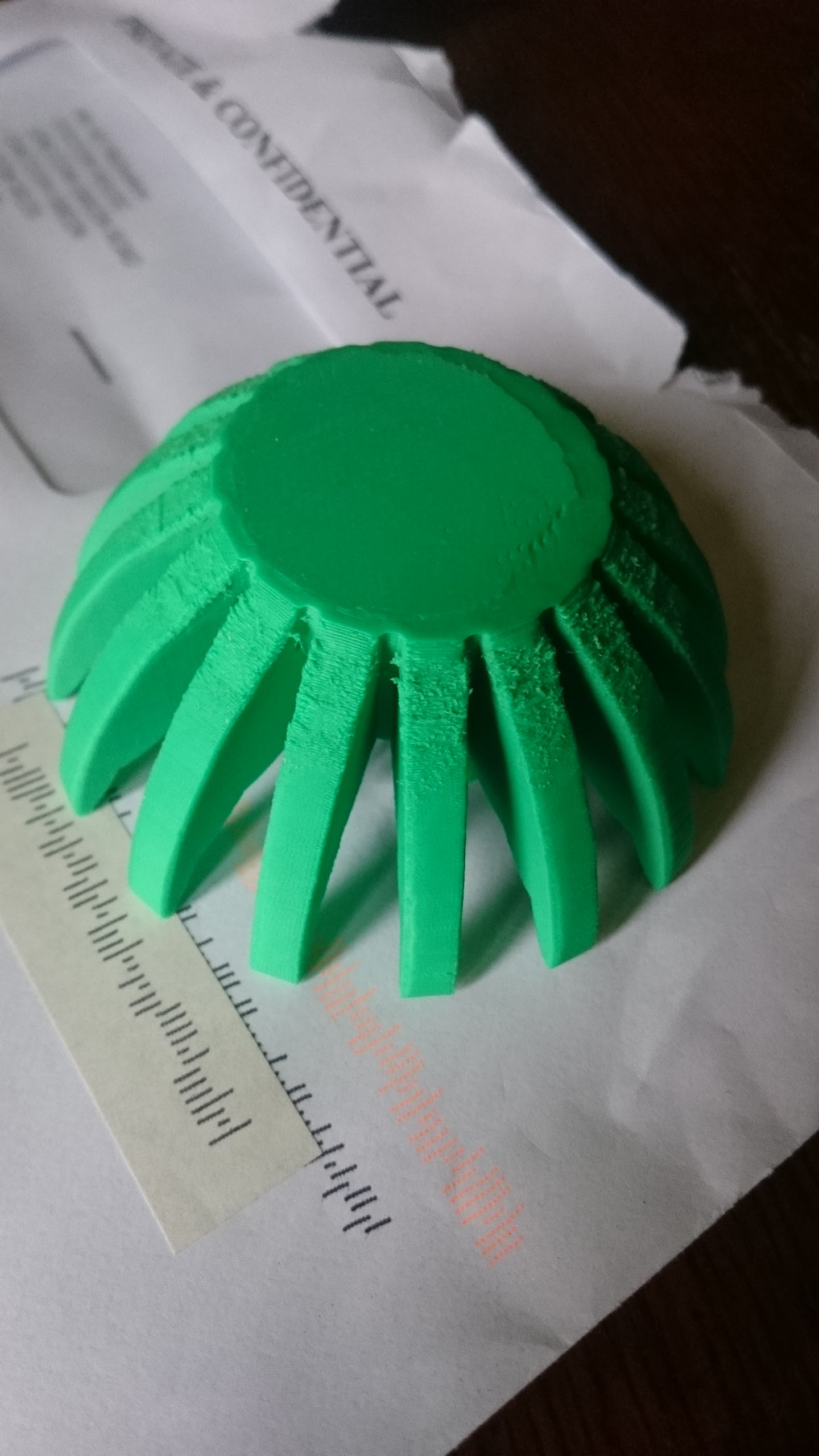

Update to my issue any suggestions thanks
Not sure the first few layers don’t print right, the item should be opposite way up
Could be too steep of an overhang on the first few layers. If you printed it the other way around in comparison to the photos I believe that is your issue.
If it’s PLA, then you need a print cooling fan to help with this problem. I usually have my fan up to full speed by the 3rd layer (if I’m remembering right).
Too steep? Maybe add support… And a cooling fan.
Are you using a heated printbed? If so, switch it off and use a gluestick for part adhesion instead. The heat radiating from a heated bed can curl up the edges of an incline print. A fan only reduces the effect but doesn’t take away the cause.
We need some more information. Type of material, heated bed or not, printing temps… and what are your concerns about the print?
Yeah heated bed, not sure on bed temp will check, abs material, fan on always
Using any bed adhesive type material?
My comment only applies to PLA. as for ABS, switch of your fan.
