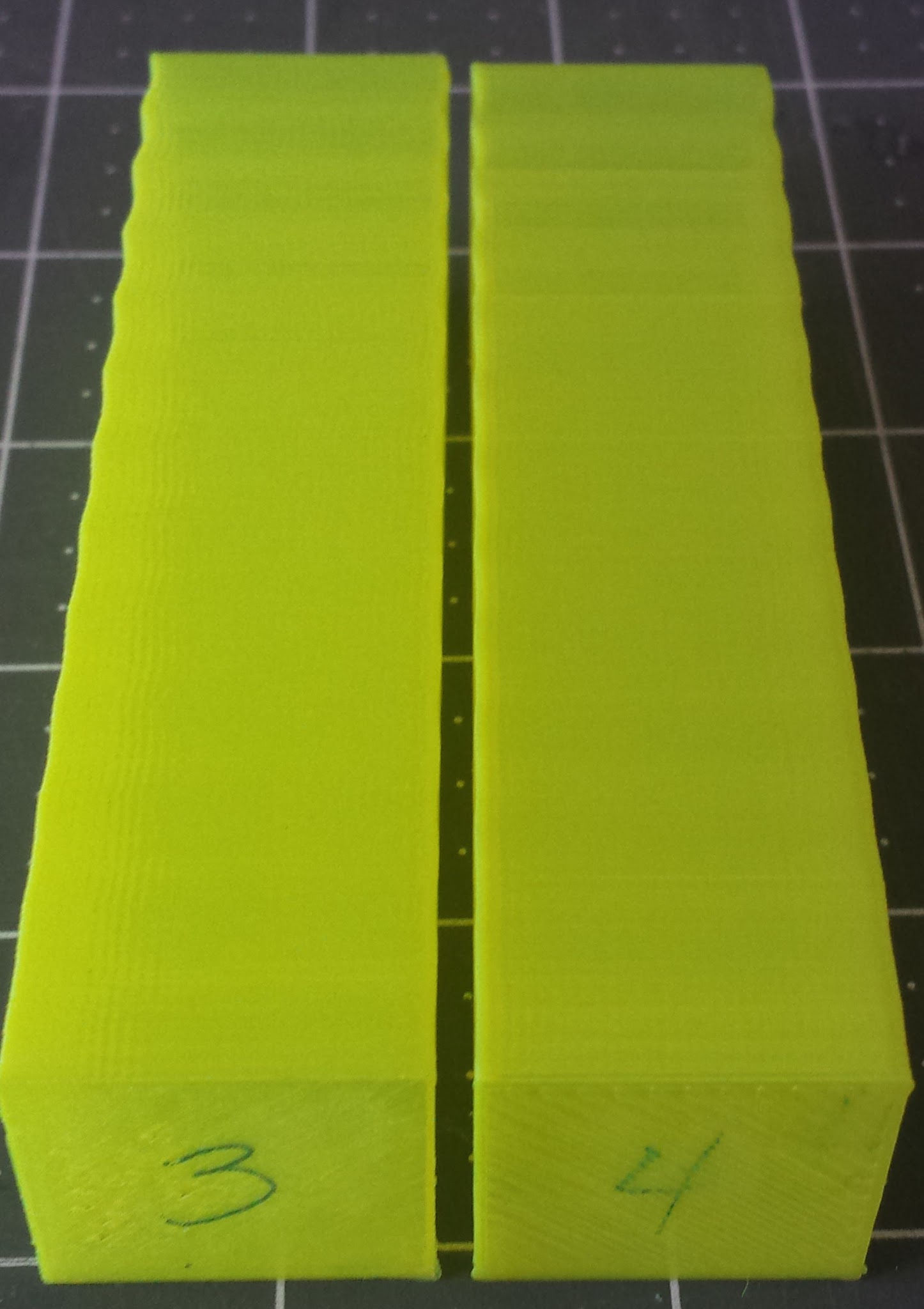

Update to the update… I found a loose stepper motor connector on my Ramps board when I went to swap the left and right Z axis connectors to troubleshooting. It seems to have fixed a few of my issues. Now when I run the Z axis up and down, they stay the same.
The one on the right is the newest one. The amplitude of the waves are a lot less. No 100% but a lot closer.
It’s increasing as it goes higher. Everything about it shouts leadscrew/treaded rod to me. Can post a picture of your printer from the front, side and top

No obvious way that the motor connectors could cause this comes to mind. I think a more likely explanation is that while the motors were disconnected, one or both of them turned slightly so that they were in a different phase relative to one another when they became electrically coupled again and were re-energized. You were probably seeing waves from the two screws that were largely constructive before, and are now getting more destructive interference. That’d be my guess, anyway.
BTW, if I’m right, it may be possible to further reduce the waves by rotating one screw relative to the other (or you can go the other way/too far, and make it worse again).
It also means that to truly fix the problem both rods/couplers need to be replaced. You don’t have just one bad one.
