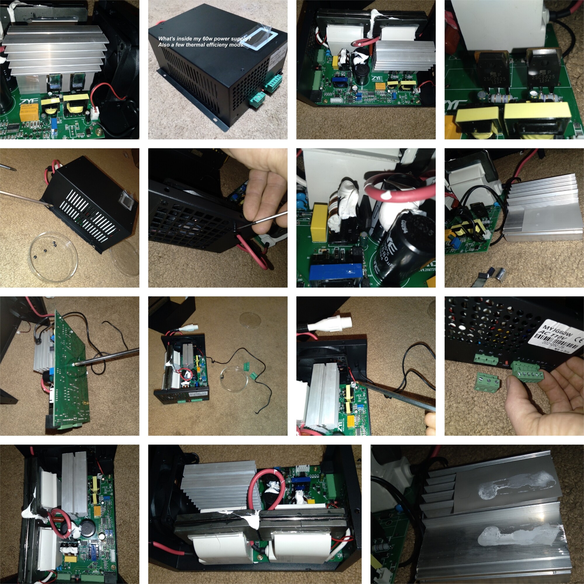

Let us explore what is inside the 60w laser power supply and how I modified/will modify some aspects of the inferior cooling.
Extremely high def photo right click and see full size.
This is a ZYE 60w power supply
WOW FUJI MOSFETs
Also, Look at the pitiful amount of heat paste the manufacture has behind the MOSFET pad. This upgrade was not free! I want to keep it working cool and nice for a LOT longer than the manufacture intended.
This is a brand new PS I took this power supply apart to see what parts I needed. I took the big heatsink off and reset the 2 MOSFETs on it with new thermal grease.
I have reassembled the power supply and will install it in the k40 soon along with an 880mm tube. Coming soon! So apart and back together same day! Will have to take it apart again to make the changes.
When the mica arrives I will drill and tap a hole into the heatsink and screw the MOSFETs to it instead of the clamps it came with
Also, I am going to desolder the capacitor in front of the bridge rectifier and screw a chunk of aluminum to it with some thermal paste.
So here is the scope on a list of what I think can be done in this PS to make it last.
- upgrade fan
- upgrade cooling thermal transfer point on 2 MOSFETs on the giant heatsink. Install thermal grease and mica insulator to improve thermal transfer.
- a.) de-solder capacitor to uncover bridge rectifier add a heat sink to bridge rectifier, re-solder capacitor.
3 b.) or de-solder bridge rectifier, add heat sink, and re-solder
