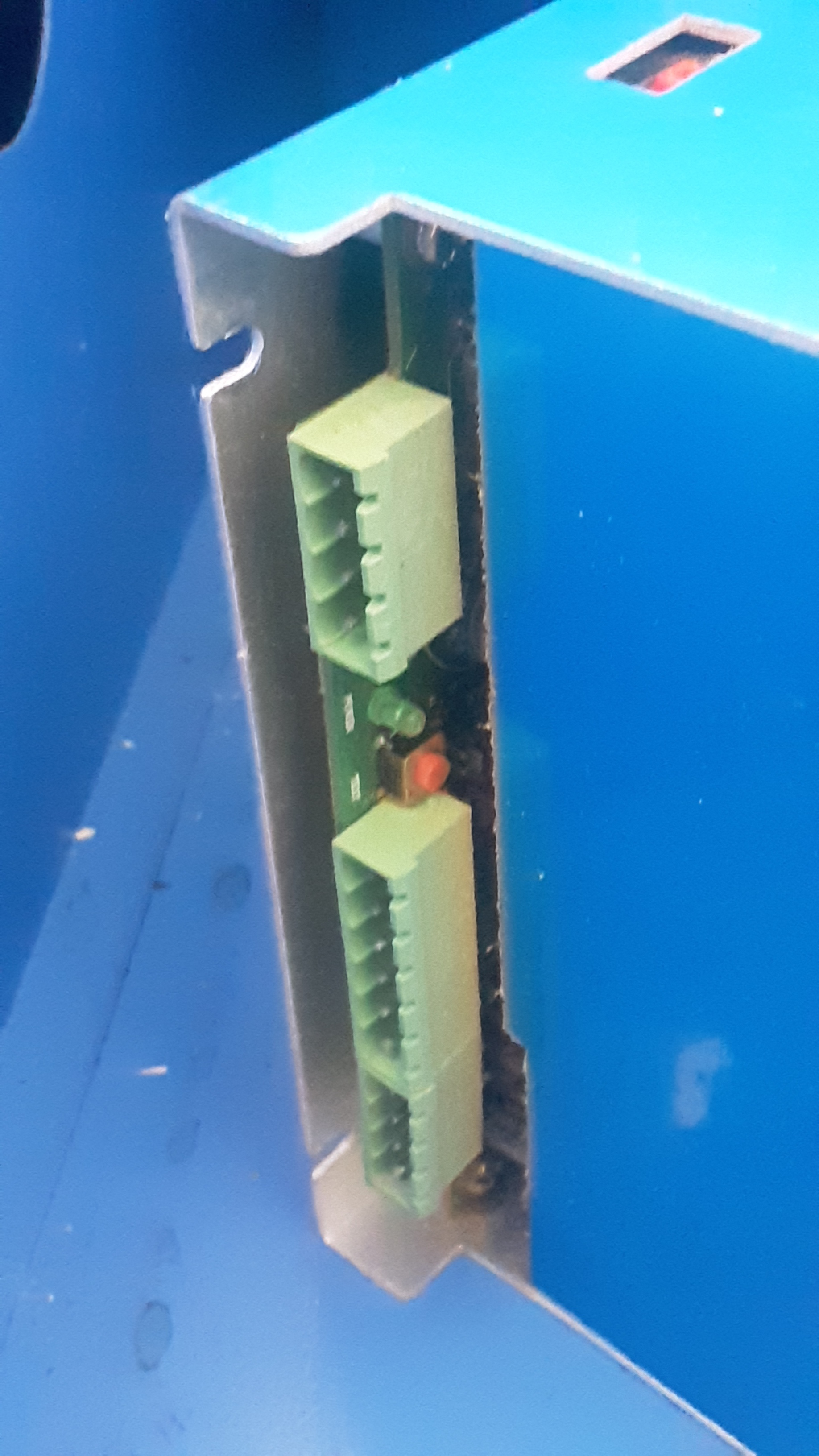

Depending on what LPS your have and which 60W LPS you pick will determine how much wiring will need to be done. It’s not a tough upgrade and we can walk you through it. - Post picture of you current LPS and the one that you want to replace it.

LPS input connectors
Ok, finally got around to handling this. I suspect you’re asking for the control board, bit adding a pic of the external panel as well…
Looks like you will have to do some rewiring for the new 60 W LPS.
How much rewiring depends on the LPS you pick.
At best its just mogins some wires, at worst its doing some retermination.

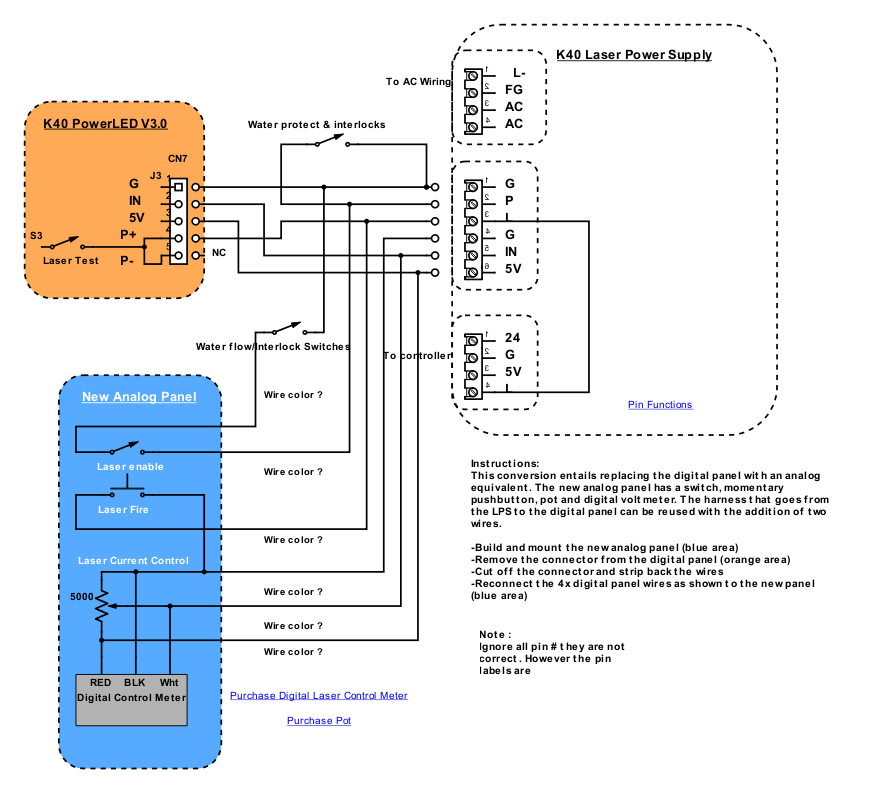

We have helped folks through this before and I think I have wiring diagrams for such.
If I were you I would think about adding a laser current meter at the same time.
I would also consider just changing the panel to analog control and loose the digital panel.
The control board and software need not change except for the controllers connection to the LPS.
Here is a schematic of one conversion to analog using a standard K40LPS.
Yours will not have the 24V DC connections.
We can customize it for your conversion once you decide on:
- LPS
- Digital va analog panel
- Current meter

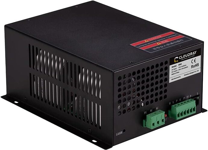

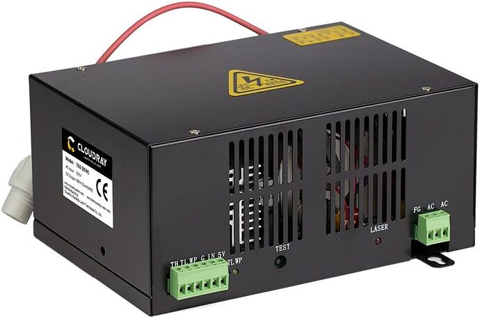

Here are some LPS selections:
These are from cloudray:
[** longer warranty and better flyback]
This one from Light Object seems to be a new model there are two versions one with protection features, more expensive and longer warranty
I did not search ebay much but there are 60w supplies there that are cheaper but I do not know about warranty and returns.
