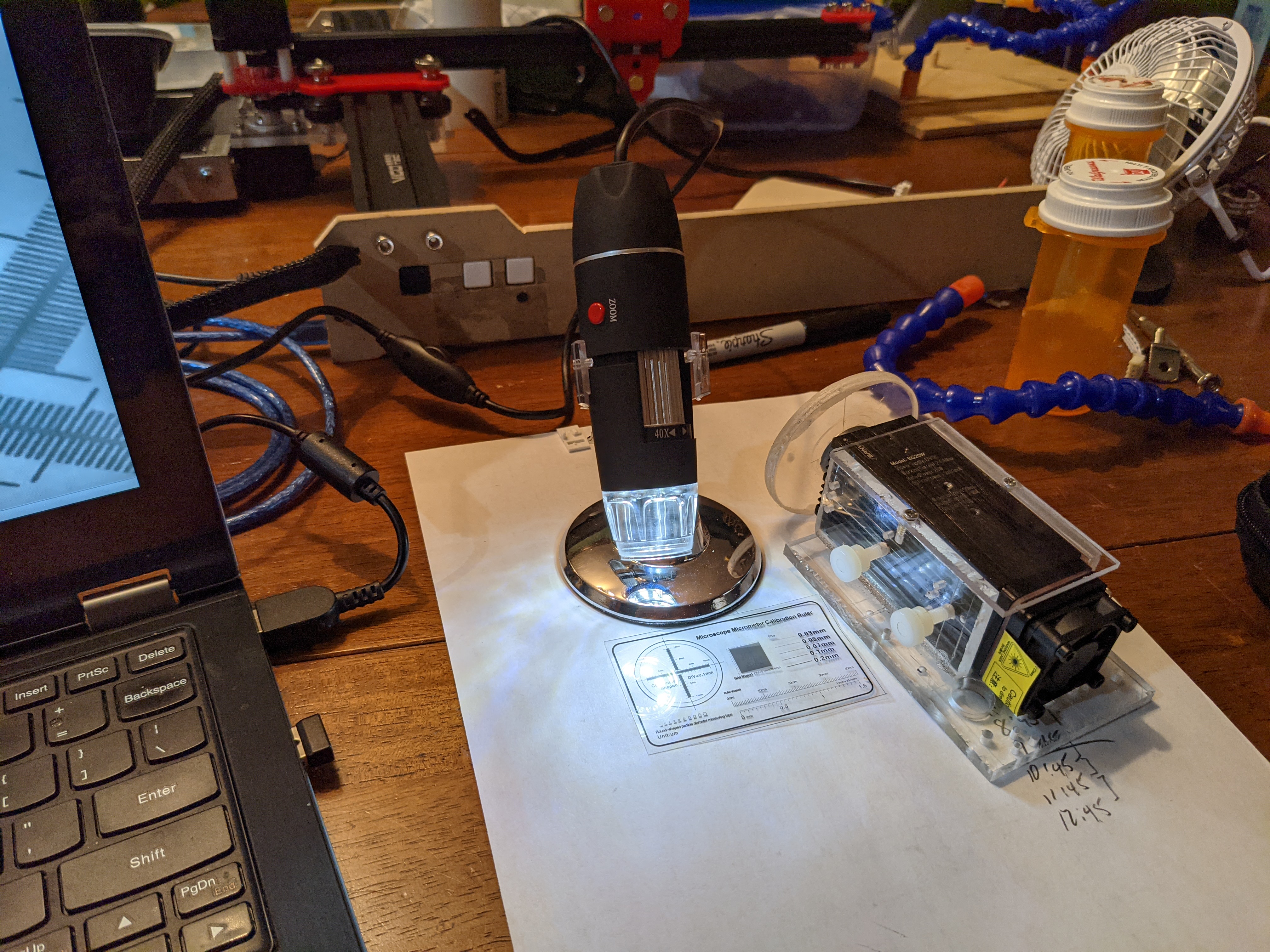

I set out to buy a USB microscope and follow the lead of some others to use this for focussing my laser diode engraver.
After some research, I chose this unit; https://amzn.to/3lnjjEq
It worked right out of the box (connects like a webcam) including my Windows PC and Android phone.
It came with a nice zipper case, holder, software disk, USB adapter, and graticule.
I was happy with the image it created and even if it does not end up being the best way to measure focus I will use it for electronics projects and measuring images.

Well I finally had time to play with the USB microscope. It is really not bad for the price. It is a 640 x 480 camera. The picture was very clear on my monitor so I will not complain. It looks like the camera is the same one that is integrated into the all in one that I purchased awhile ago. I am including a picture below. In the included instructions, they say that if you email them, they will offer you a great deal on a metal stand. When I went to the website to download some additional software, I was greeted with an offer of a free stand by just emailing them my Amazon order number. It was different than the one in the instructions so I emailed them both. We will see what transpires. Bottom line, it is a good microscope for the money even without the stand. It will be used. Thanks Don! (said with dripping sarcasm!!)
