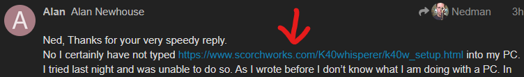

No I certainly have not typed https://www.scorchworks.com/K40whisperer/k40w_setup.html into my PC. I tried last night and was unable to do so. As I wrote before I don’t know what I am doing with a PC. In fact I don’t know how I got Whisperer VO 52 and Inkscape 09.2.3 on to it. Initially I found Lasergod on my MacBook and clicked on here and here again to down load both programs. Perhaps when I typed Whisperer and Inkscape into my PC both programs were found because both my computers are on my wireless network. I confirm my control board is * 6C6879-LASER-M2 ( M2 Nano ). I did take photos as you requested, however all of my photos have disappeared. When I went online to sort that out I found there was many others with the same problem. Decided to try and sort my laser problems first before bothering about my photos. Finally I have noticed that when asking questions some say “I am a newby” My excuse for appearing to be stupid is I am 83, Regards. Alan.
