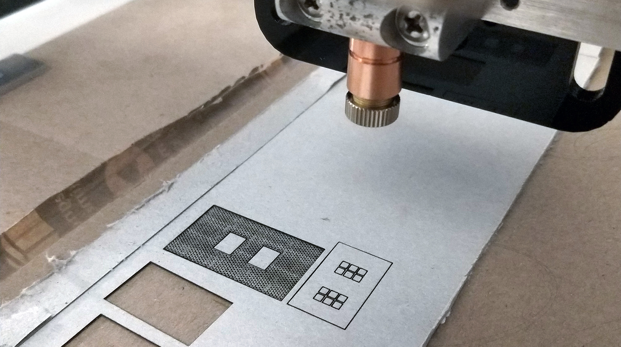

Used LaserWeb with my new diode laser to make some N-Scale (1:160 scale) buildings. The machine is an OpenBuilds Acro style with a GShield, NDB7875 9mm 445nm Laser Diode, and a JTechPhotonics driver. Fantastic resolution on the cuts, now I just need to polish up my painting skills.
looks awesome!!! How many watts is that laser? What material are you cutting?
@Ariel_Yahni_UniKpty 3.1w peak, though I run them around 2w without any thermal issues. I’m cutting 0.6mm cardstock from cereal boxes.
@Ivan_Iakimenko at what speed?
@Ariel_Yahni_UniKpty For full depth cuts I do 3 passes, full power (2w), 800mm/min. For engraving to a depth of 0.2mm I do one pass, full power, 0.06mm laser diameter, 1000mm/min.

I do not use my diode laser to cut plastic, my K40 CO2 does a much better job with that. I prefer my diode for detail work and more delicate materials that the CO2 laser would blow through even at the lower settings.
@P_Mido plastic and cardboard are very different.
