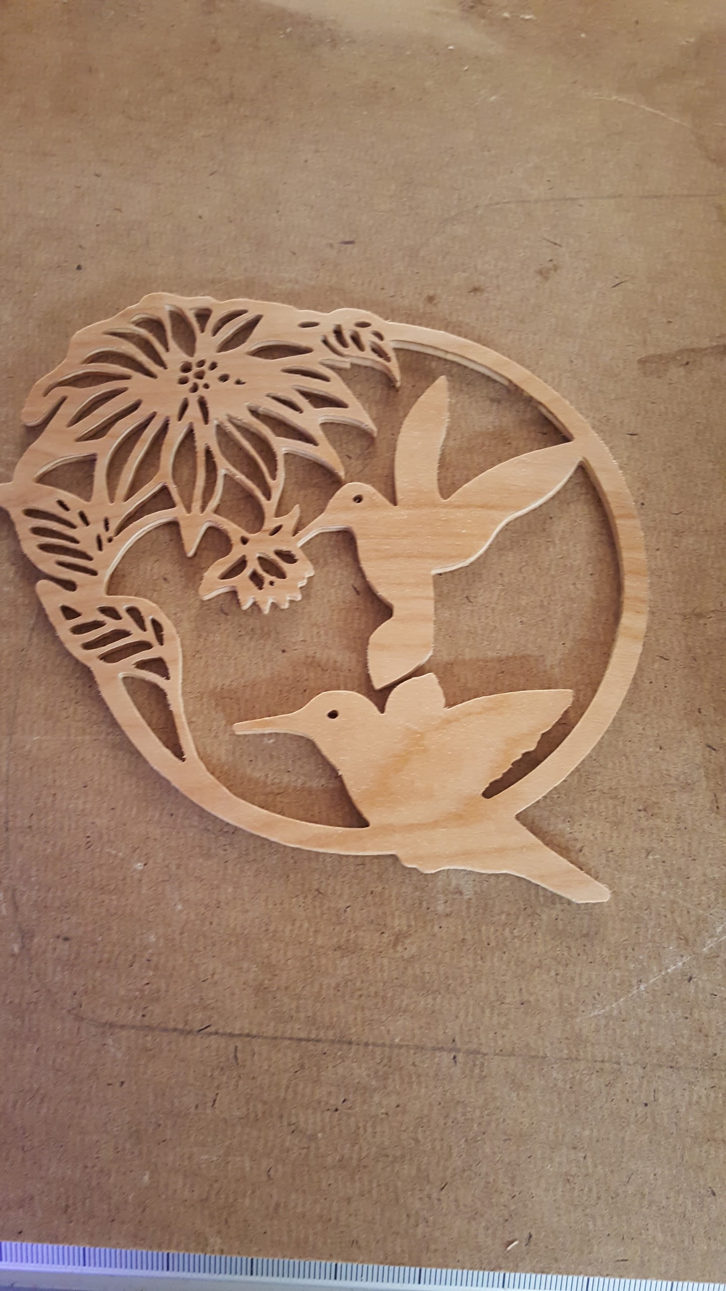

Used the Shapeoko 3 to try a scrollsaw pattern, pattern courtesy of Steve Good.
Well done!
Would you give us more info please: software to generate G-Code? Bit used? Feedrate? etc. Inquiring minds want to know :sunglasses:
Hello I used Vcarve with 1/16" bit feed rate of 40 . And I took it down in 3 passes.
Thanks.
What’s its size? 4"?
How long did it take for the 3 passes?
You use the recommended Dewalt spindle?
Apologies for being nosey.
Hi Matt, no worries, the backer is 10 x 10 and yes I used the Dewalt 611
