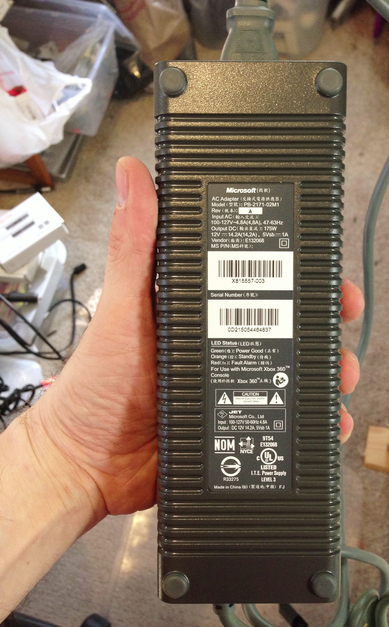

Useful power supply discovery of the day: XBOX 360 power supply bricks deliver 12 volts at up to 16 amps (!!) and can be found for about $20. Nice form factor, relatively tidy cabling, widely available.
I’m starting on a 1000+ pixel project which is going to need a fair amount of power. Unless something changes my mind soon, I’m going to use an XBOX 360 power supply brick to give me the amps I’m going to need.
I got a 150 watt model (14 amps) for $20, and an XBOX 360 to XBOX Slim adapter cable just to dissect for the weird connector. I hacked together a hardwired power switch box, and I’m good to go: 12v and a nice number of amps.
So far tonight, it looks cheaper, more powerful, and better quality than the “8 amp” 12v power bricks I’ve used before, and sleeker and more finished looking than a loose ATX PSU or something similar.
I’ll report back on whether it blows up, toasts my project, and burns down the house. If I still can.

So this is why I like the XBOX360 power supply bricks: they’re compact and ‘finished’ looking, they deliver a hefty deliver 14-16 Amps, and they can be had for $20. It’s the combination of all three of these things that makes them a good option.
