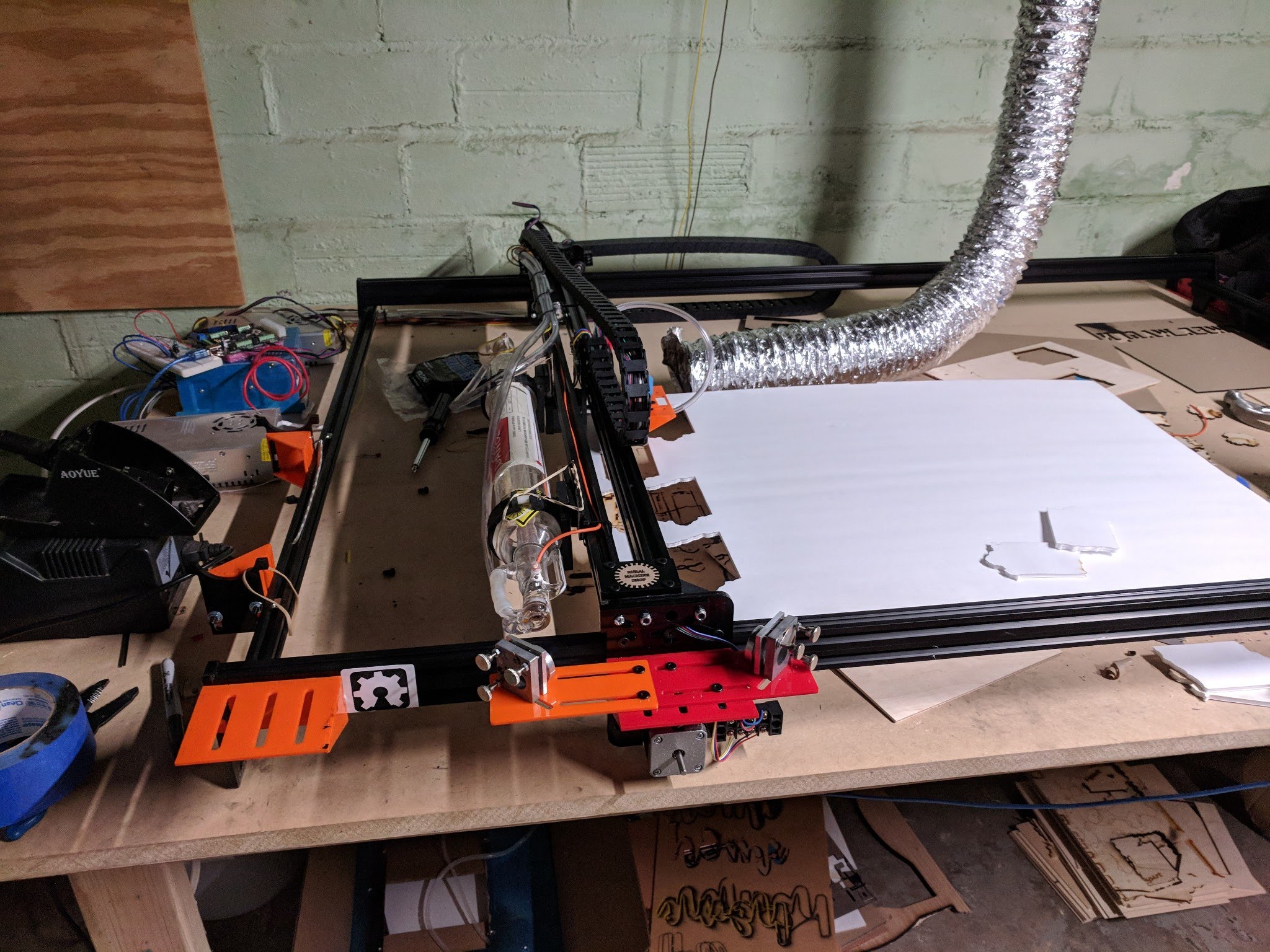

BTW would love to see that setup
@Joe_Ternus so you added another profile on X and ride the tube on it. Been thinking about this for a while.
Yeap. Eliminates the need to align the first mirror! So much easier then having to deal with 1.5m of alignment
@Joe_Ternus have you posted your parts somewhere?
It’s on openbuilds under k40 acro conversion. That doesn’t have the gantry plates though. Adding those soon
@Joe_Ternus how did you connect the high voltage to moving carriage?
@donkjr very carefully through a drag chain using high quality wires.
still seems like a really long run on the HV line, and I would aim the tube at the wall rather then the room (and possible ppl)in case the worst happens
You haven’t had any leaks from the water tubes either? and have you noticed and reduced flow of water(in liters/min) from the length of them? what size pump? Im sure many of us are curious also
looking good though!
Haven’t run into any issues yet. Standard k40 pump. I point the tube this direction as I was more confident that it would hit the first mirror in the ~2" of space it travels rather than the last mirror be perfectly aligned and missing the laser head. Soon enough there will be an enclosure and this won’t been issue.

@Joe_Ternus I have wondered about the reliability of running long HV wire for some time. Most HV wire is pretty stiff. If that becomes a problem there are silicon types used for car spark plugs.
Are you running the HV wire with other wires in the drag chain?
@donkjr I am. Not sure if that’s the best idea, but I’ve had no issues so far
@Joe_Ternus it’s surprising that you are not getting HV crosstalk and sending the controller bezerk. If it arcs it can destroy most electronics.
@donkjr yea, now that you mention it a second drag chain wouldn’t be a bad idea. Maybe even on the other side of the machine. I’ll look into that
@Ariel_Yahni_UniKpty Looks a bit like how it’s done in the FABkit… They too use a chain to guide HV wire and water tubes…
Perhaps @FabCreator (@Bonne Wilce)is willing to share some details about the wiring they’ve used?
We use the standard HV that comes with our PSU, but we dont use the k40 psu so dont know if there are differences in quality of cable.
HV cable will be stiffer than most cable so its important to have a larger radius on the cable chain so the water tubes and HV wire are not under a lot of stress. Your cable chain looks to be quite tight but as you dont have much z height a larger chain would not be easy to add unless you flip it and put it on the xy axis like some 3D printers do for the filament path. Cube x
