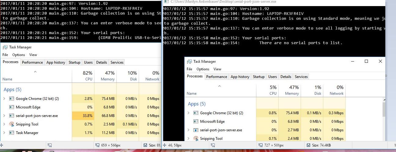

Using Chilipeppr/nodemcu, disconnect USB and SPJS is fine for a while. Then I hear my drive working like crazy, go into task manager and see this. Close SPJS and it stops. Start SPJS again and it’s fine. Cannot find a repeatable case, yet. Something in SPJS is sucking up a LOT of computing doing, something…

Caught it again with -v on. I flashed a new firmware and tried to connect to it and the hard drive started going.
