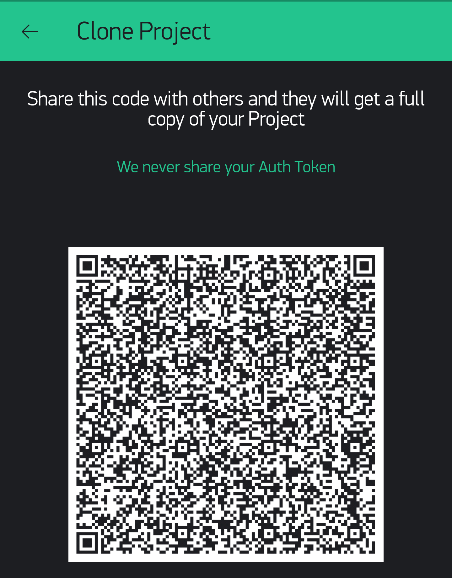

@Mark_Biasotti I just updated my Gist to show a basic example of my projects minus the functions for the animations. Should give you a good framework to build off of. This barcode will load the project into Blynk for you. It should anyways, but I use a local Blynk server so it may not load. If it doesn’t work I will post a screenshot of the setup itself.
