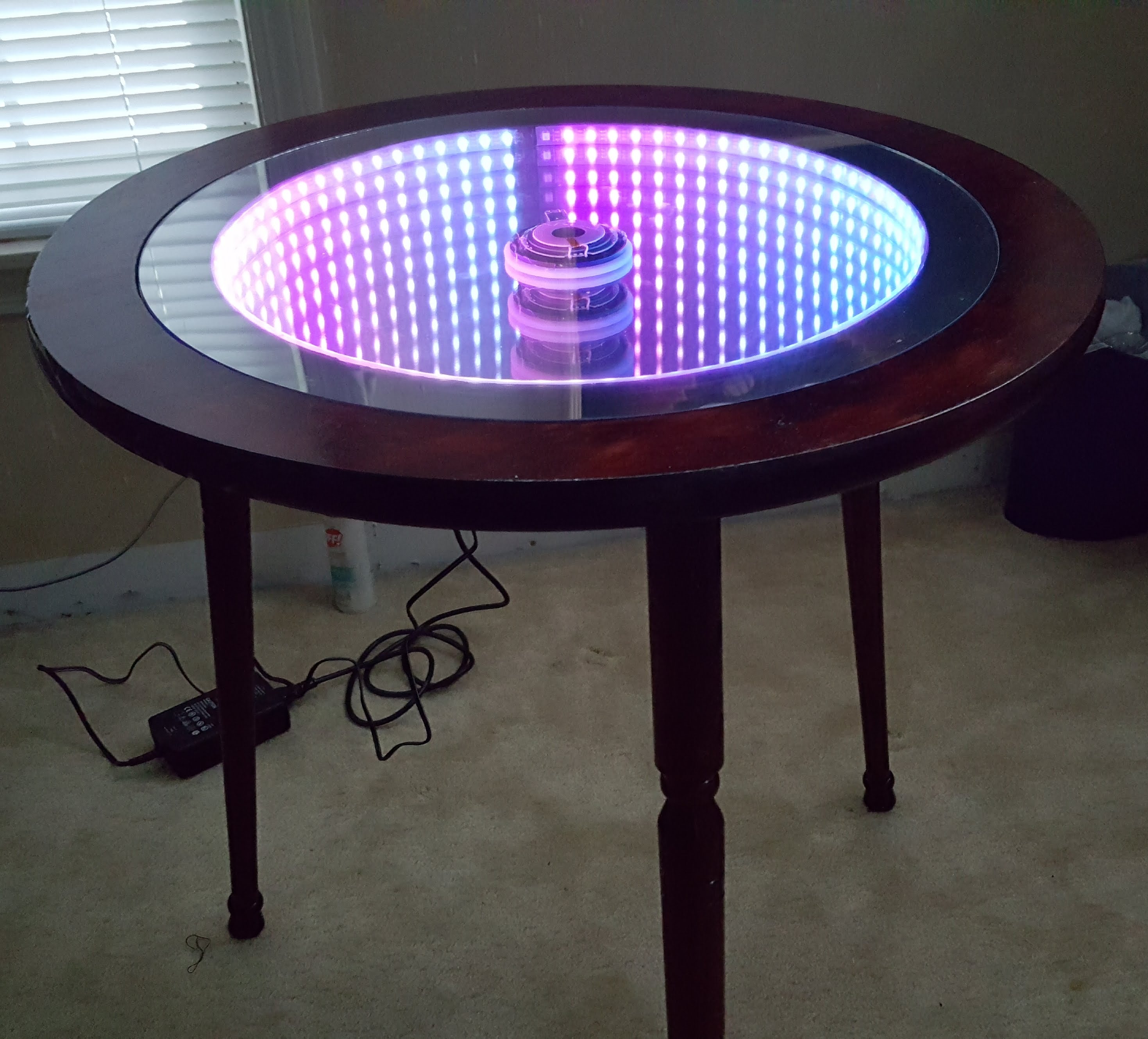

Using @Jason_Coon ​ esp8266 FastLED webserver, I finally finished a bedside infinity mirror table for my son. I have to fix the sketch as I ended up including an addition LED. I also incorporated a wireless phone charger in the center of the table, because you can never have enough chargers! I had to remove the casing of the charger so it would charge better through the 3mm tempered glass top.

Looks great - did you use privacy film and put it on the glass yourself? Or did you find a manufactured one way mirror?
I have yet to be able to put the privacy film on anything larger than about half a square foot without any noticeable bubbles, but perhaps that’s just not in my current skillset :slight_smile:

Looks great. Any information on the build process and materials used?
I will try and get a list together, but the base is mirrored acrylic and I did use transparency film on the glass. Believe me, there are many bubbles in it as I tried to do it myself. It’s my first attempt at building one…woodworking is not a strong suit for me
