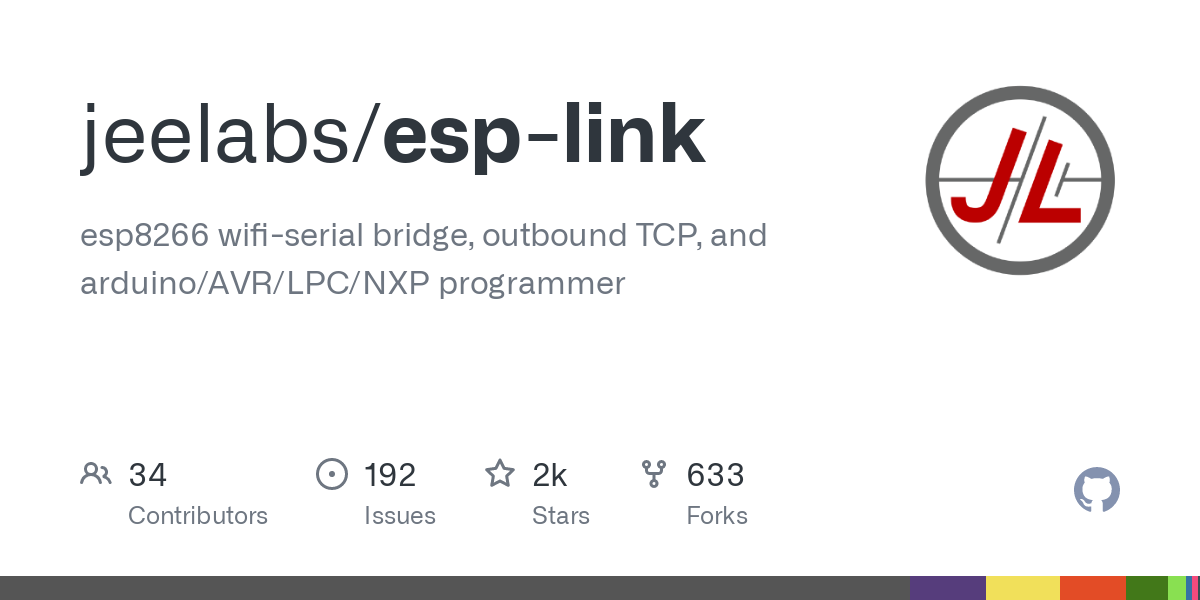

I’ve used esp-link for some low speed stuff for a while but recently moved to just using an rPi.
I had a Java client app running on an rPi before just moving the rPi to the RS232 device.
Thanks for the link, however, esp-link does not appear to be compatible with ChiliPeppr. At least not as far as I can see. Are you running the ChiliPeppr compatible serial server on the rpi?

Well, first, I’m ALSO new to ChiliPeppr so it’s entirely possible that I misunderstand, but when I connect to the “serial port server” via the web browser, I get a /list/ of the ports available in JSON format. I assUme that this is expected by the workspaces? I mean, how else would it know that I have 2 built in serial ports and a USB adapter plugged into the PC I’m using for my CNC machine now? I don’t see anything in the esp-link system which shows a JSON format list of ports. It does list the ports, and perhaps could be adapted to support ChiliPeppr, but doesn’t appear to /at this time/. Is yes? No?

PS(edit) In the absence of that you should check out Wifi Serial Bridges and servers; this might be a good place to start; it talks about how to run the esp-link code @dougl linked to above to provide a ‘virtual’ serial port you connect to as if it was a local usb port or device, but actually talks to the esp over the WIfi to communicate with the controller.
It’s important to note that using WiFi/Bluetooth comms from a PC to a CNC controller is essentially a ‘solved problem’, and many people have done this using tools like esp-link.
Oh, I think I understand. esp-link connected to CNC. Local PC somehow sees that as a local “virtual” serial port. serial-port-json-server on local PC connects Chilipeppr to the virtual serial port? Bit of a kludge, but hey, if it works, it works! Thanks.
Yes, that is how I imagine this would be set up.
There may be alternatives such as having a PI (or similar) connected via USB next to the machine running serial-port-json-server. There may be other ways, I’m just not familiar enough with this to know.
