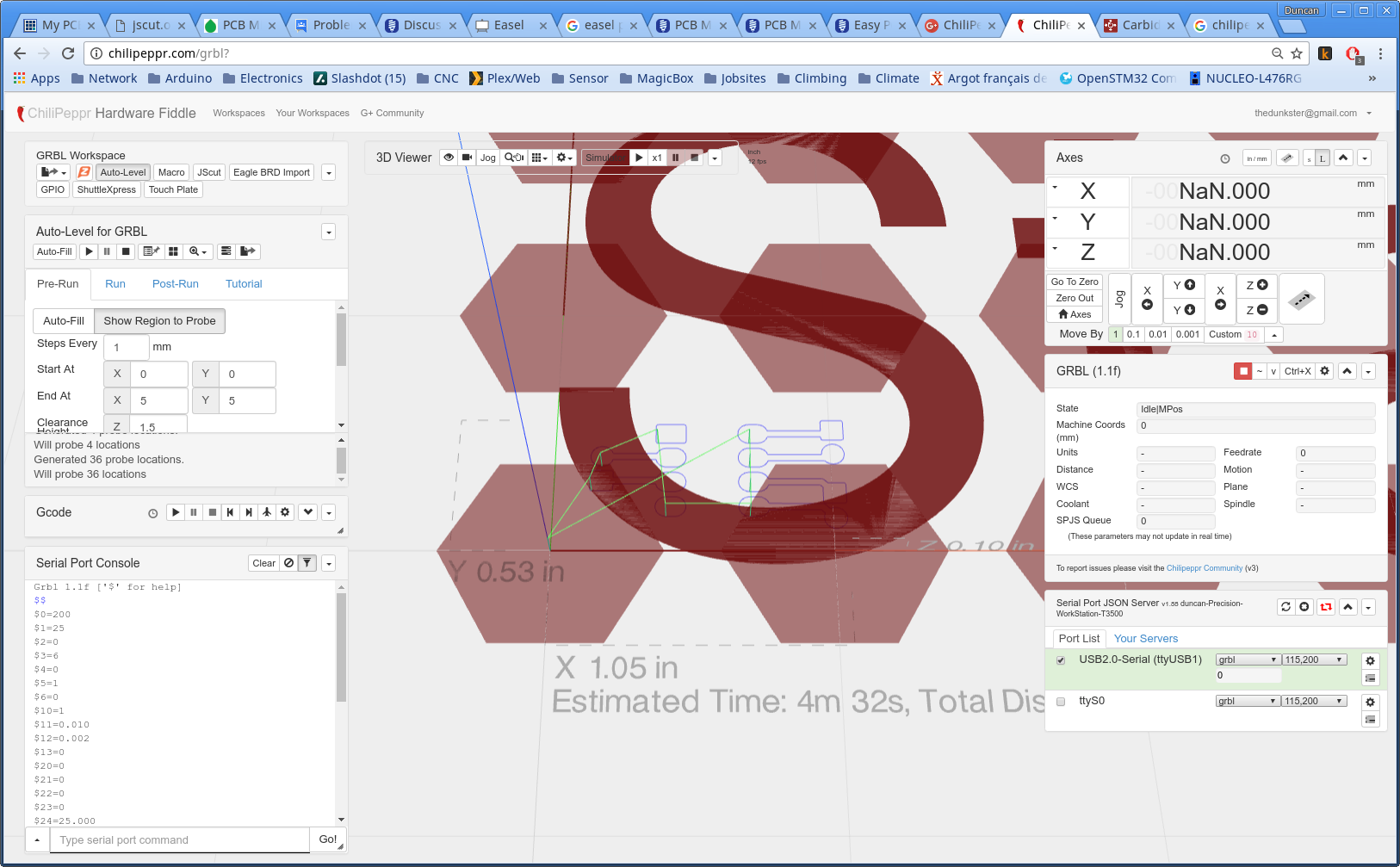

I can’t get auto-levelling to work properly. The 3D viewer shows that the autoleveller seems to have mixed up units. Set to test every 1mm, but points are shown at 1-inch spacing.

Forcing web-gl enabled has fixed the rendering issue, but the mm/inches confusion is still there
there should be no confusion if the gcode is in mm. everything should standardise to mm ok.
there is an issue (if you are using /jpadie) with using inches. I was trying to force the reporting and display to standardise to whatever the gcode was using. but there are a whole bunch of other widgets that seem to want to have a say in the coordinate system, so I am going to give up on the standardisation push. I will try to push a fix later today.
