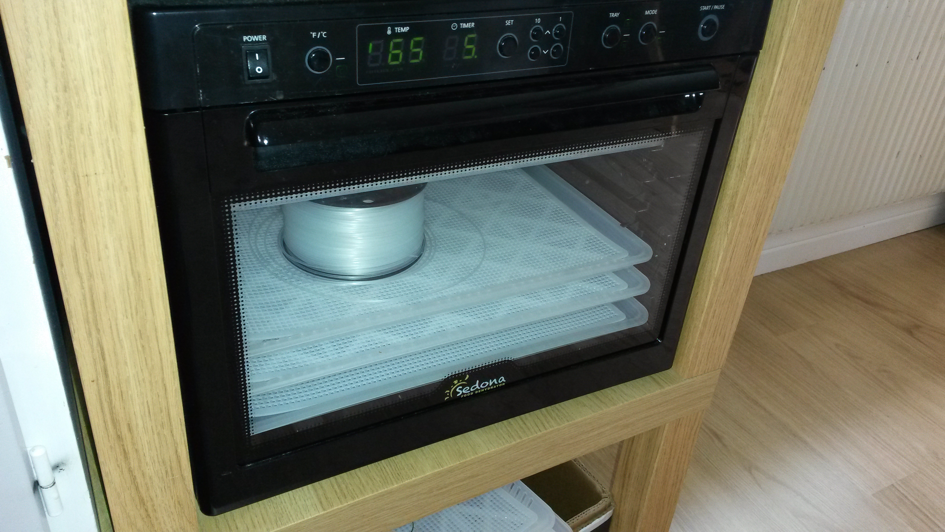

Using wife's food dehydrator to dry my filament,
Using wife’s food dehydrator to dry my filament, will be interesting to see how well it work. :slight_smile:
Let us know.
What temperature does it work at?
I will, it works up to 68C (155F) but I set it to 65C for no scientific reason.

@Chad_Louis I don’t think that so, there was no smell at all from the plastic while drying and lego is made of ABS, this is nylon :wink:
It seems to have worked fine, I got a lot of popping while extruding the nylon before. Now it extrudes smoothly like it did when it was new. Dried it for 16h in total. (let it dry overnight)

You can dry nylon at 80-85C with no issues. 4-6 hours is adequate for 1lb at 180F.
Keep in mind that it’s best to not dry the filament more than a couple of times unless you use a vacuum oven. Thermal cycling will negatively affect its mechanical properties.
Also, at ~50% relative humidity, nylon is fully saturated in approximately 24 hours, so you definitely want to keep it sealed up once dried.
