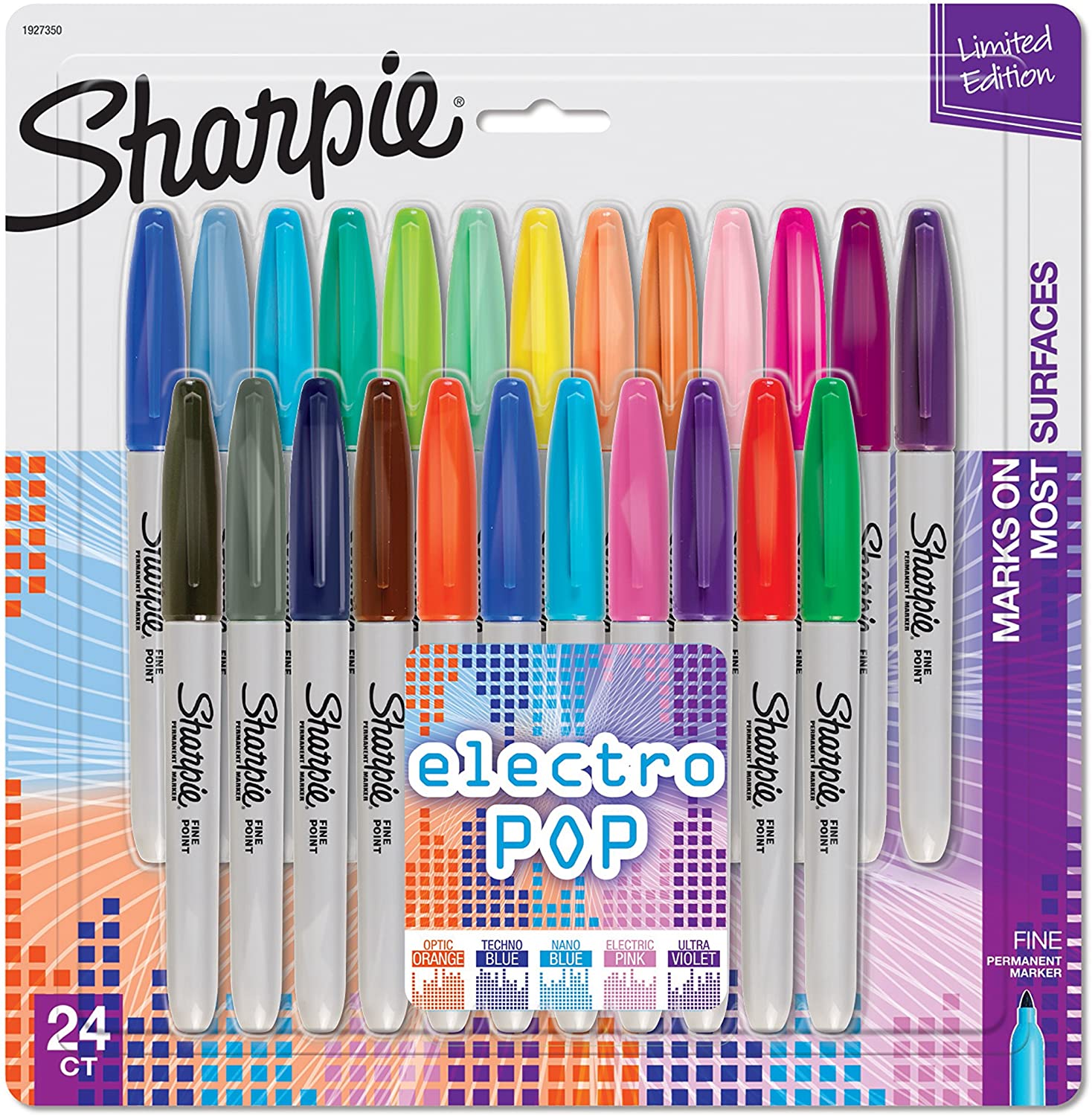

If I’m going to paint unengraved areas I don’t pre-finish as the paint doesn’t spread evenly on the gloss coat and takes at least 2 coats because it doesn’t soak in. Acrylic craft paints work well for opaque coloring, but you can also use permanent colored makers, like sharpie brand, to give a transparent color like a stain.
I also sometime use paint pens, especially for white. Pen type applicators like sharpie markers or paint pens are faster to apply then brush on paint.

I had not considered using sharpies, that’s a great idea. I have seen some people use paint pens to great effect. In one video that I watched someone used something that they referred to as a lacquer pen/pencil but I have never seen anything like it in all my googling. It looked a bit like a grease pencil.

Sharpie markers are alcohol based and just flow into the wood very evenly. Almost impossible to get splotches unless it’s grain density issue. Then I usually just come back after it initially dries to darken any high grain density areas.
