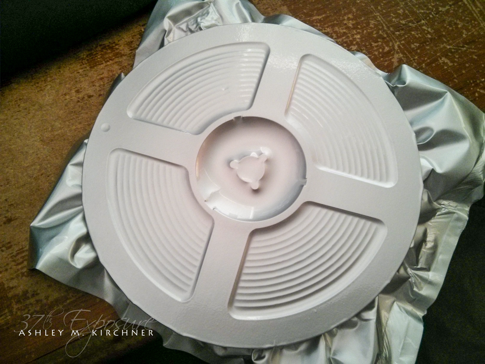

Vacuum pack anyone? I think they may have even sucked all the air out
Vacuum pack anyone? I think they may have even sucked all the air out of the individual pockets on the tape as well. Eesh.
In that respect, they are correct that the humidity will ruin the parts … if you don’t take proper care prior to using them. Not only do I put fresh desiccant packs in all of my shipments, I also toss in humidity indicators. Despite it being rather dry over here, the little humidity that we do have occasionally can and will ruin stuff. So I keep a close eye on everything I use. Especially after a sealed packet is opened.
