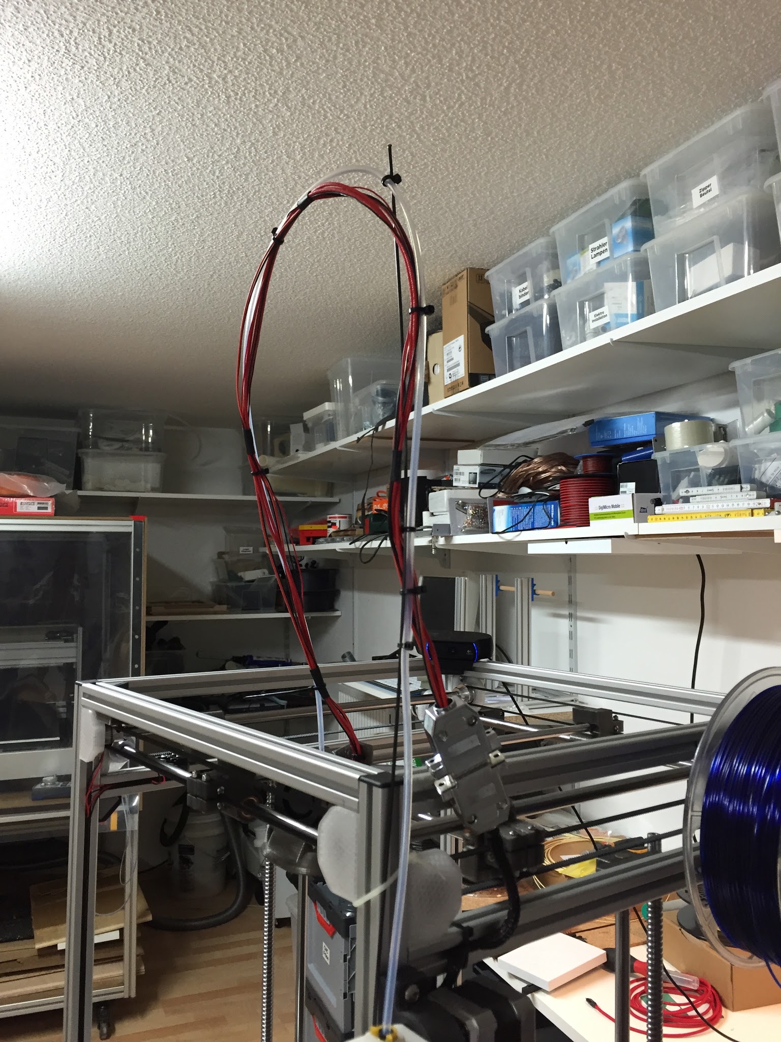

At least the continous extrusion seems to work well now. I’ve selected a print that works without much retracts and printed that vase with the 0.6 nozzle and 0.4 layer height quite well. I’ve changed the bowden tube to a longer one (950mm is really massively long, @Eclsnowman - sure we need that much of an arc?) and found a carbon stick to support it - that works ok for the moment.
I’ve also just reset the Bondtechs setscrews as they seem to have used too much force and also rechecked all Slic3r settings for now (@Eclsnowman do you still not forget me regarding your factory files? :-))
I now changed the nozzle to a 0.3 and try to print Marvin. As it prints right next to me now i see quite some overextrusion that shouldn’t happen - i have to remeasure the filament but from what i saw so far it seems to be of rather bad quality when it comes to diameter consistency - that could be an additional problem.
