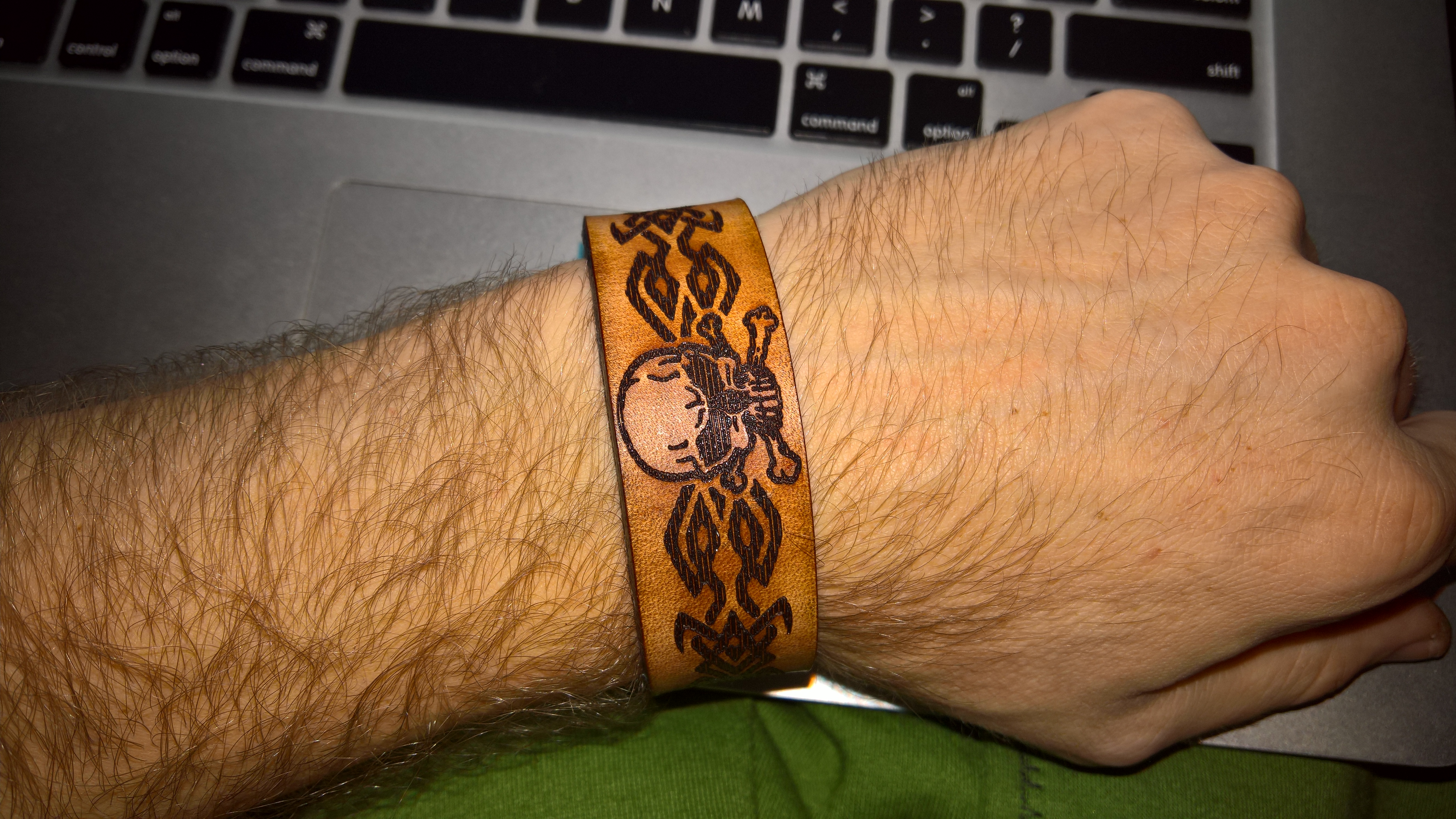

Vector Engraved Leather Wristband 1 pass @ 4mA @ 50mm/s - Orange 200gsm cardstock
1 pass @ 4mA @ 50mm/s - Orange 200gsm cardstock test cut
1 pass @ 4mA @ 20mm/s - Leather (~4-5mm) Vector Engrave
- 0.5mm rectangles, 0.25mm spacing
3 pass @ 10mA @ 20mm/s - Leather Edge Cut (accidentally had it on hairline border thickness)
10 pass @ 4mA @ 20mm/s - Leather Edge Cut (fixed to 0.01pt border thickness)
Observations:
- Vector engrave @ 20mm/s seems to work nicely
- Almost 0 vibration
- Minimal smoke when vector engraving
- 10mA edge cutting created a lot of smoke (hence the soot residue on cuts)
- 4mA edge cutting created minimal smoke but required a lot of passes to get through the leather
- Very clean edge cuts
- Could have done with 1-2 more passes (as the leather fibres were still attached at the bottom <1mm)
- Could have spaced the rectangles closer, as on leather the gap is noticeable (maybe 0.125mm spacing)
Leather Finishing
- Quick wipe with methylated spirits (to remove soot residue)
- Boiled beeswax wiped over both sides & edges
- Allowed to dry
- Heat gun applied to set beeswax into leather fibres
- Excess beeswax wiped off as soaking into leather
