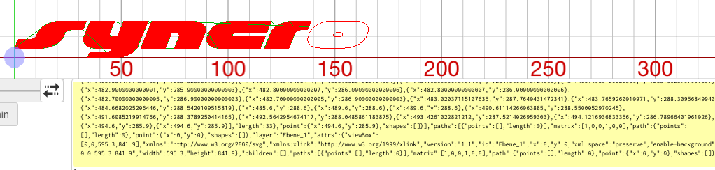

I have a problem with my LaserWeb. I imported an SVG-Vector File (built with Illustrator - the text exported as SVG, didn’t work … before exporting I converted the text into vectors … Didn’t work too)
After importing in LaserWeb, I always get the same issue …
“The file has minor issues. Please check document is correctly loaded”
The “o” in this text isn’t in the gcode as always … I don’t know how to fix the Problem! I think the font isn’t as good … But I don’t know why I have the same issues after converting into vectors before exporting.

Text always needs to be converted to pathes (lines) as LaserWeb (and most other softwares) can not interpret fonts. Illustrator is known to create SVGs that can make problems. A workaround is creating a new file with Inkscape and import the Illustraor SVG into it. Then save as standard SVG again.
I can check your SVG if you post it.

I tried your workaround with inkscape, but it doesn’t work. Laserweb doesn’t use the “o” in my SVG.
I attached you my Test-file (illustrator-SVG)test1
I found the problem. The o was 2-3 times on top of each other. This can cancel out the contour for LW.
I have ungrouped all, then marked a line segment of the o and deleted it, then the next line segement and so on, until only one contour left.

Just FYI, the “minor issues” message is shown whenever the SVG file contains an element that is not handled by the LaserWeb SVG parser. It does not necessarily mean that there is anything wrong with the file, just that there may be some parts of it that will not be cut correctly.
