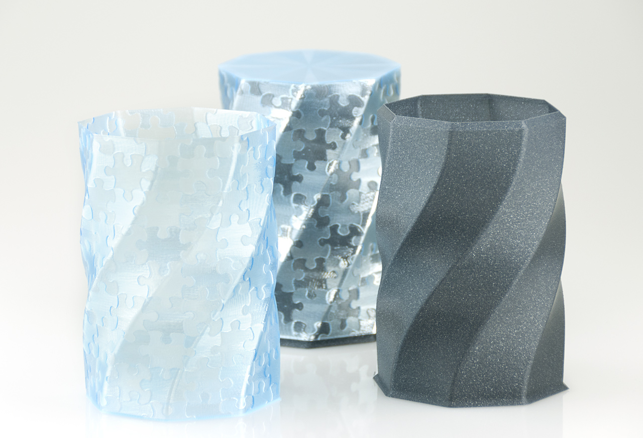

Velocity Painting A helical box and lid, the lid with a tessellating jigsaw pattern.
Velocity Painting
A helical box and lid, #VelocityPainting the lid with a tessellating jigsaw pattern.
I’ll put the STL, pattern and instructions for this and other velocity paintings up on my new site http://velocitypainting.xyz soon.
800mm/min slow, 2400mm/min fast, 0.5mm perimeter in spiral vase mode on a @Think3dPrint3d Kossel Mini, @Fillamentum1 filaments.
The two, umm, pen pots in the foreground of the first image were supposed to slide together like the box in the background, but i didn’t realise that Rhino, by default, twists things to look pretty rather than linearly so they don’t go together :smiley:

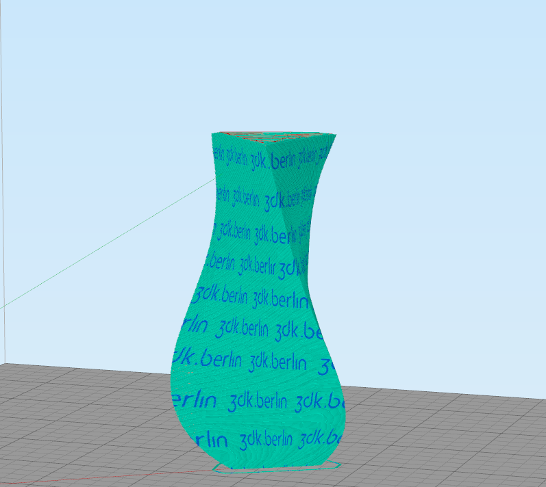

:bulb: And maybe I am discovering the wheel again, but the exported “painted” gcode can be easily imported back to Simplify3D and visualized with all the beauty of the velocity texture using the setting Show in preview → Coloring → Movement Speed. :wink:
@Tomas_Vit Absolutely, yes, just drag the gcode file onto S3D.

How do you stop the patterns from “stretching” around the surface ?
@Daniel_Stauffer Just make the pattern wide enough to wrap around nicely. Here’s the pattern I used in this instance:
@Mark_Wheadon I have an object I would like to paint with a logo (. And it wraps oddly (it stretches) so I made up a theory:
If one would know how which area the lateral surface of a given object occupies, he/she could make a pattern occupying the area of the lateral surface. lets say you have a cylinder of r=30mm and h=100mm the lateral surface is 18849,56 mm2. So one would have to make a pattern of 100mmx188mm and it should wrap nicely.
I am checking this right now. Thanks!
@Daniel_Stauffer Agreed. I tend to think in ratios – so make it high enough (in terms of pixels) for a good resolution, then wide enough to match the object’s ratio of girth to height.
