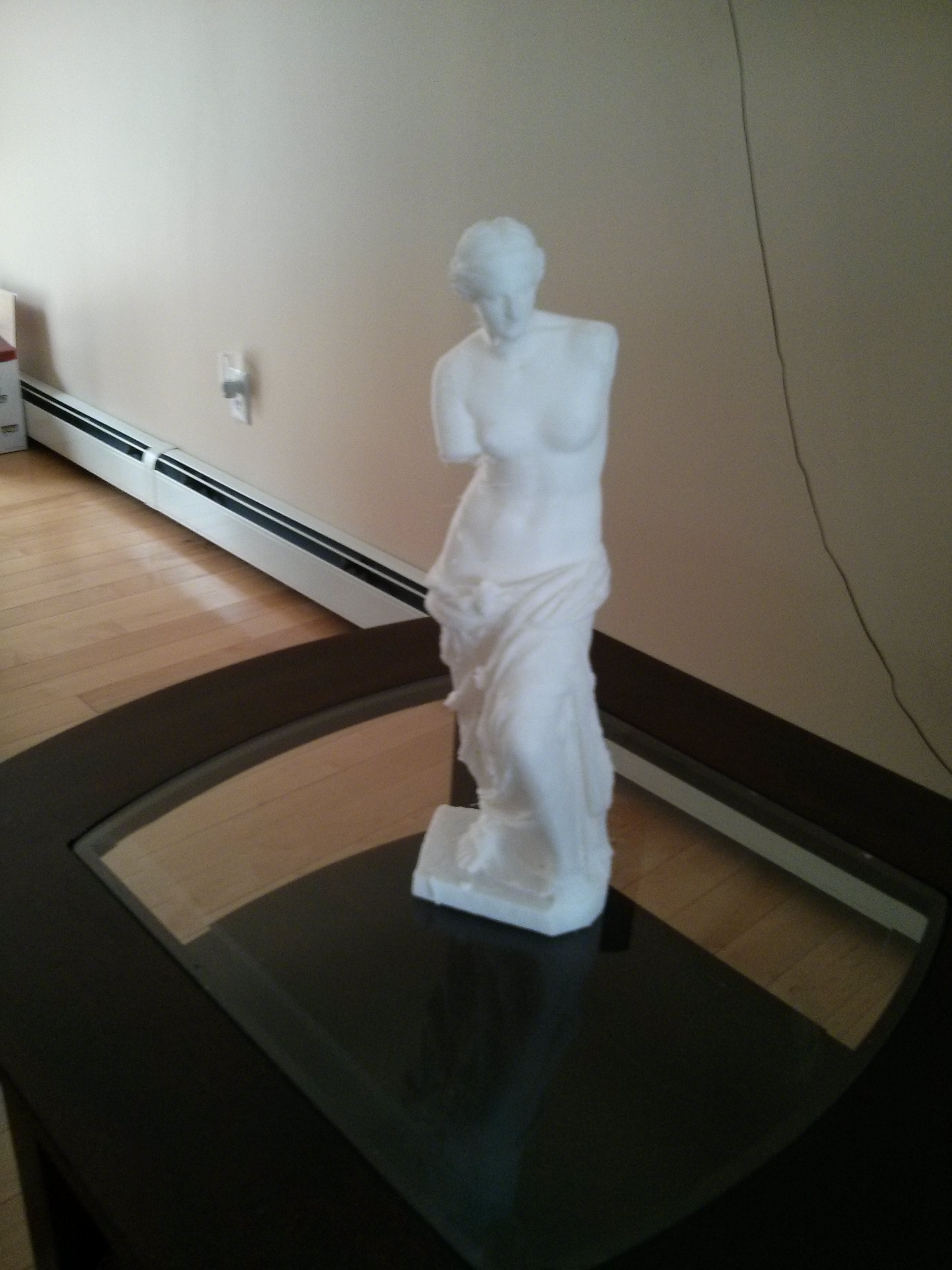

Venus de milo, took 70 hours to print, 40cm,
Venus de milo, took 70 hours to print, 40cm, printed in one piece on modified printrbot simple 2014, the printing head jammed twice, had to drill it, repetier crashed once. I managed to restart the print without much visible artifacts.
Wow, impressive seeing such tall prints from a printrbot simple. Has quality suffered any from the height mods?
As you get higher and move the head in Y direction it wobbles in X direction and also Z little bit. To mitigate this problem I print at a slower speed. As I get higher I decrease the speed to 50%, 25%. I also print infill first, then perimeters. Woobly infill doesn’t matter and by the time it starts printing perimeters the head stops wobbling. Doing this there is no quality loss.
Nice, I really like the idea of gradually slowing down to compensate. I guess it could help on more moderate prints as well. My Prusa i3 has OK stability but it’s not great :stuck_out_tongue:
