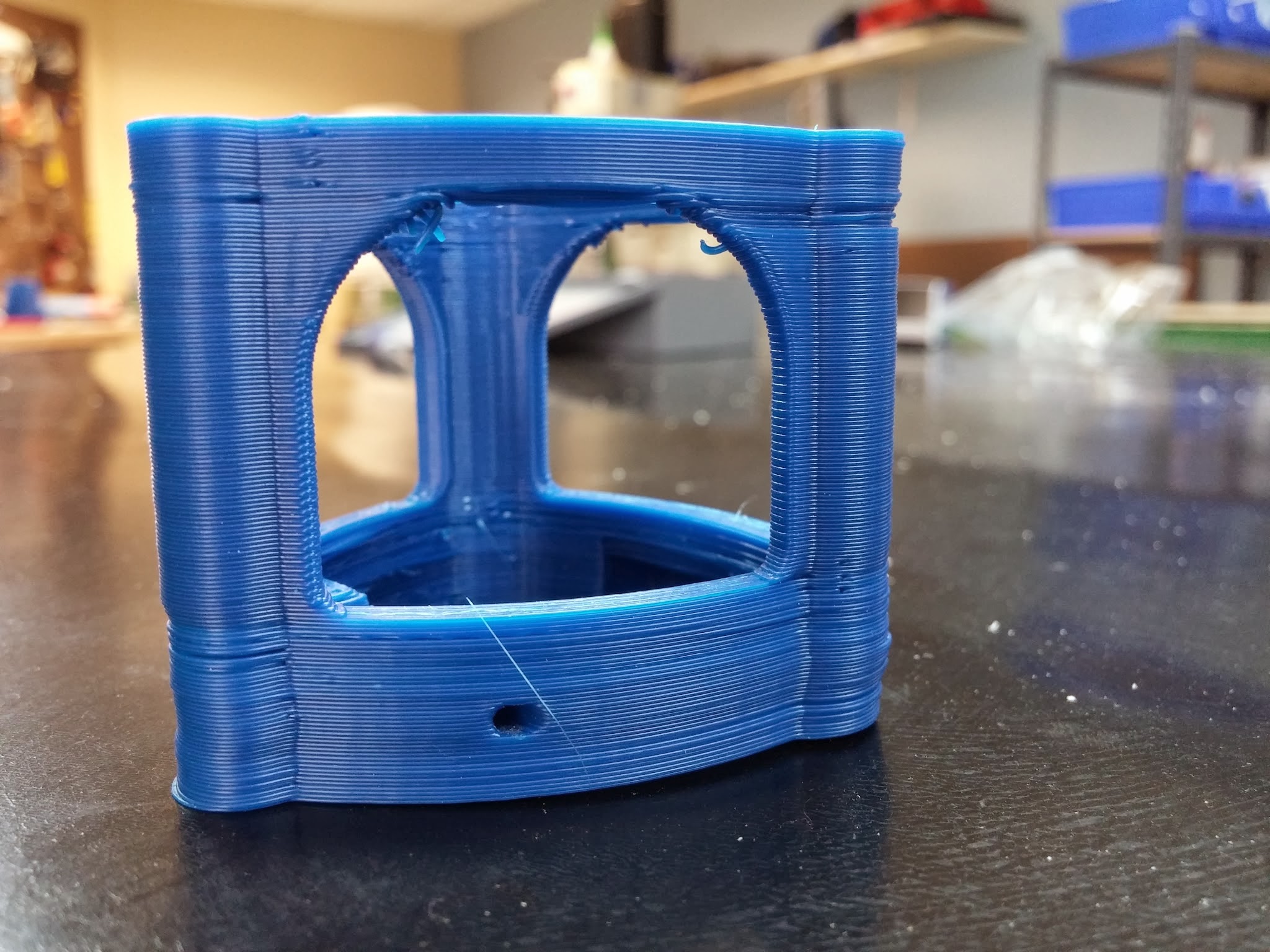

version 0.1 of hotend probe mount for rostock max - anyone have an idea
version 0.1 of hotend probe mount for rostock max - anyone have an idea if filament diameter or some sort of vibration is causing these artifacts? I’m still learning the non-intuitive delta printer wonkyness of print problems…

To further elaborate, I’m talking about the banding/ offset bulges that occur low in the print, and what might be a separate issue of over-extrusion at higher layers

Difficult to determine the cause of your problems, my best guess is that you still have some play in rods or carriages. Have you tried reducing acceleration and jerk?

But familiar with printing delta, but it’s that ABS or PLA? With ABS, I get that “registration” when I print pillars like that, then connect them, as the pillars warp and lean a bit while printing, so they are mislocated slightly when they are all bridged together. This would not explain why you have the same effect prior to the pillars though…
It’s ABS, but the columns print and stay aligned just fine. Just weird ribbing / corners on the early levels. I think I might need to adjust my printer radius? (the concave/convex correction value.)
possible too hot or Z-wobble?
