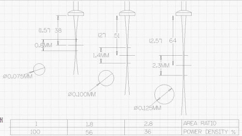

This may help explain it… But yes focus to the middle of the material for the best cut

Depends. Typically yes. But for acrylic where I want to smooth a low power cut (score) or an engrave I often de-focus the laser. For most things there’s no real difference top vs middle focus too - especially with 1/8" material.
