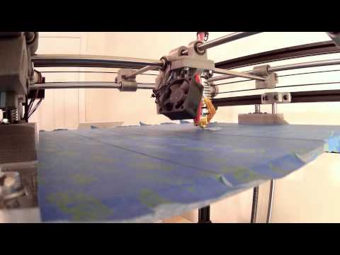

Very first #Eustathios print!
Originally shared by Jason Smith (Birds Of Paradise FPV)
Looks great for a first print. What are the vital stats? layer height, speed and acceleration, etc.
Layer Height = .1mm
Speed = 60mm/s
Acceleration = 3000 m/s^2
Material = PLA
Temp = 220 C
My ultimaker did not print this well for the first print. That is awesome.
