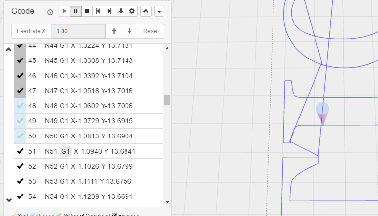

Very frustrated. TinyG 440.20 on a Big OX, Chilipeppr running gcode generated by JSCUT via dedicated laptop running JSON V1.88. There is a definite buffer issue with my job. The only way that the job starts cutting at the proper point is if I have no pre-load and no multi-line upload set. It will only start at the correct point if it is sent commands slowly. If I try to buffer any lines the GCODE widget shows that there are commands executed when they have NOT been executed. This always occurs during the time that the first “Rapid to initial position
G1 X-0.8511 Y-10.1465 F100” line is being performed by the OX. This initial move is quite a distance as the workspace origin is at the center of the workpiece and the starting point for the first cut is over 11 inches away, and it takes a bit of time to do the move. During the time that the spindle is moving to the starting position, any buffered gcode is marked as executed even though it has not been. The result is that a large number of gcode commands are effectively skipped and the cutting starts at the coordinates of the last gcode line after the one that the widget shows as being executed. The GCODE widget, 3D viewpoint and physical spindle stay in sync, but they go to the wrong point. Every gcode line in between is skipped, including, in this case, the commands to start and plunge the spindle, which immediately follow the first move to initial position. If I do turn on any level of buffering or preloading, the final coordinates of the spindle initial move are those of the last command that the system thought was executed. I don’t know who is screwing up here, ChiliPeppr, JSON or TinyG. It is my understanding that the TInyG acknowledges execution of a command, so that would indicate that it is saying it executed a command when it didn’t, but I don’t know enough to be sure of that, or what to do about it if true. The first picture shows ChiliPeppr as the OX is moving from center 0 to the initial cut point with no pre-upload, but multi-line set to 50 lines. Chili reports that 47 lines have been sent and executed while in actuality the OX is still working on Line 18. The second shows Chili just as the next 50 lines have been sent and the system thinks that the spindle is cutting. Because the plunge was skipped, the spindle is still at Z0 but the command thinks it is at Z-0.060 and the cut is beginning in the wrong place. Picture 3 is the OX starting its cut at the correct place when there is no buffering taking place. Picture 4 is an oddity that I saw in the Chili Gcode widget in an attempt to run the code with a pre-load of 100 lines and multiline of 50. I don’t know if this a a cause or effect, or something completely different. Can anyone who is still reading this thesis help me figure out what is wrong? Thanks in advance.

Hi John, Google is sticking my individual pictures together that makes it look like my snippit from the gcode file is in the same shot as the ChiliPeppr screenshot. There are five individual pictures. On the tinyG buffer in the spjs, I didn’t even know about that until I read more about the JSON server program, so I went to chilipeppr/serialport on my laptop and it did indeed show that the tinyg buffer was being used. It gave a list of possible buffers too, so does that indicate that I was in the right place?
