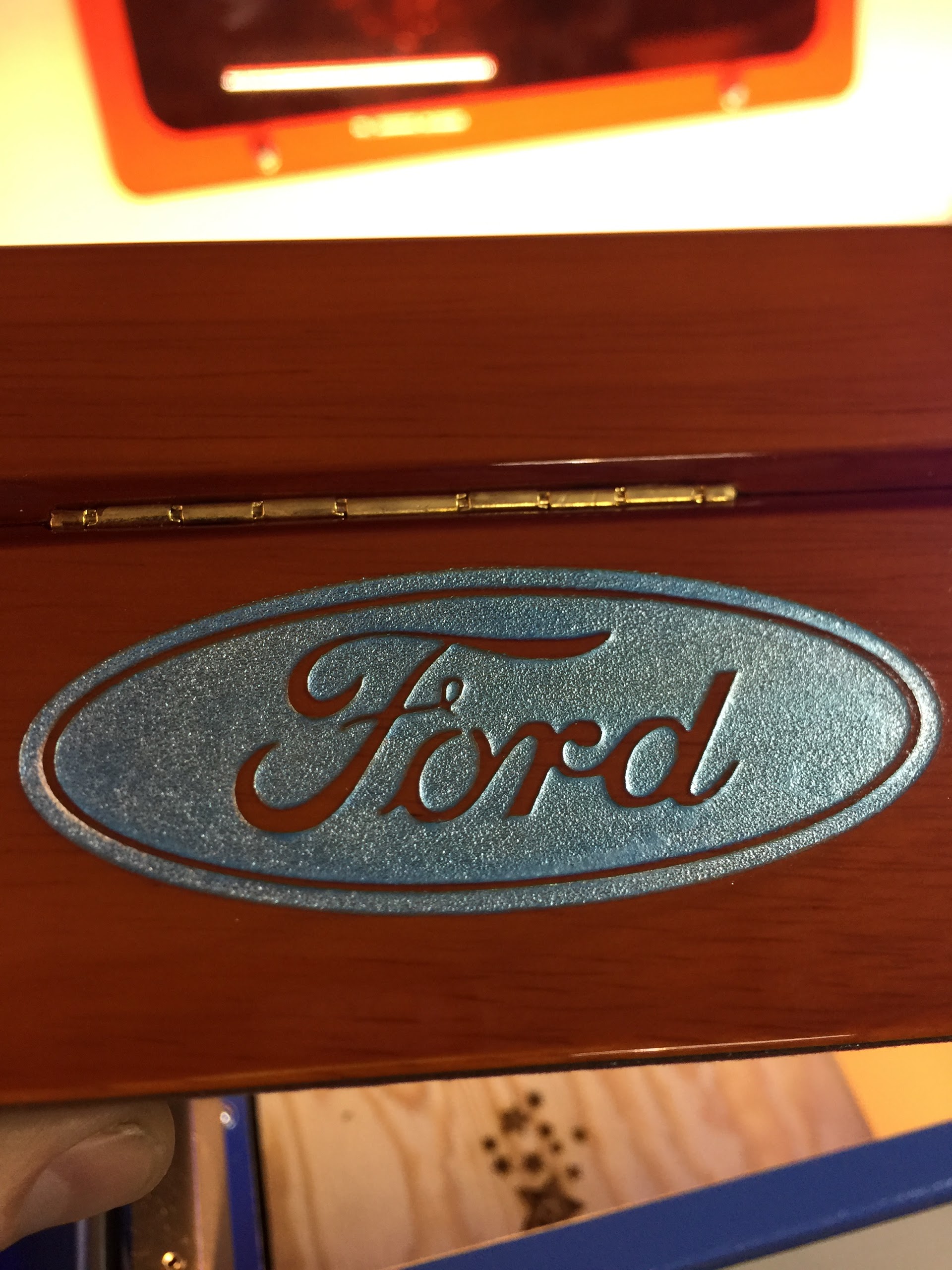

Very happy with what I'm getting. ( replaced mirrors replaced lens.
Very happy with what I’m getting. ( replaced mirrors replaced lens. CD3 smoothie board,

I like it, can you give some details how you did it please?
Dropped it down just below the focal plane so the beam was a little wider trying to avoid lines. Then used a rub and buff wax to fill the burned part let dry little bit then buff the excess off
@William_Kearns silver looks higher than wood rather than filling in to be flush with wood, did you laser a stencil out of tape and then fill that in?
No tape the silver is lower then the wood
