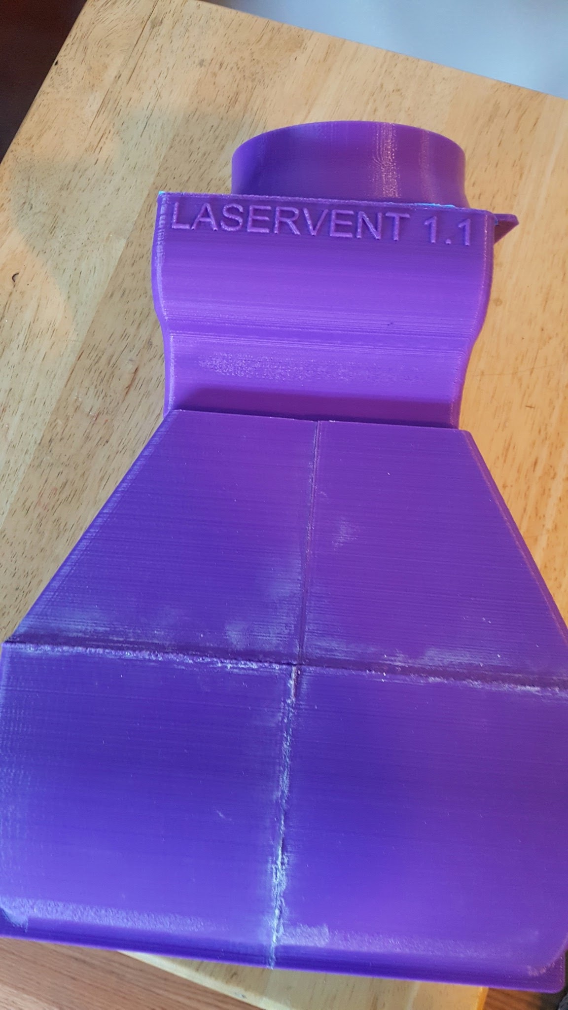

I have no idea how the stock one worked as it came out within 5 minutes of owning it. I can say that with the squirrel cage blower I have on it I don’t need the duct… just printed this guy today as an additional mod to the vent system.
