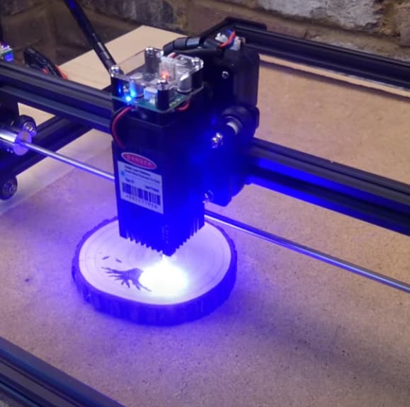

Good morning all. I just installed my VG L5 4050 and it works, but the laser doesn’t engrave anything on any of the materials, wood, chipboard, and even slipped a sheet of paper under the laser and nothing happened . Can you help me? Thank you

You will find a screenshot and a small video showing you the laser in action.
Even when passing a paper under the laser, there is no burn.
Thank you in advance.

I notice from your picture that the laser beam is not very bright?
The beam on these things typically are very bright and illuminates a larger area than you are engraving.
Is your camera filtering the light so it looks dimmer or does it really look that dim and crescent in its shape?

That beam does not look right to me.
