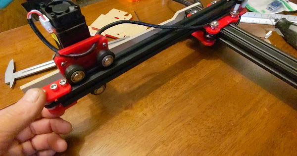

I haven’t even powered up my VG-L7S and already stumbled into some concerning findings.
I replaced the sideframe with versions that were longer so the unit would be more stable.
I immediately noticed alignment errors.
The significant finding is that the carriage wheels in the Vslot have a lot of “Vslop”.
There is no adjustment to tighten them up.

Isn’t it traditional to have eccentric mounts for 2 of the 4 wheels in a Vslot setup like this??
Any advice on using these: https://amzn.to/37vEwUT
Although I will probably make changes to remove the cantilever I will test it like it is to assess its stock ability :-1:.

I see its a while since you posted the above. I just spent the morning etching trapeziums when I thought I was etching rectangles. I think the that the problem is what you have called “V-slop”. But I’ve found that the slop changes the angle of the X with respect to the Y as well. (not important in most applications) but today I needed precision.
Have you solved the slop problem? would you mind posting how? Did the eccentric spacers work for you?
I did modify the carriage to remove the “slop”.
Best I can tell (measurements) it corrected the problem.
However I have not done much image testing with it.
