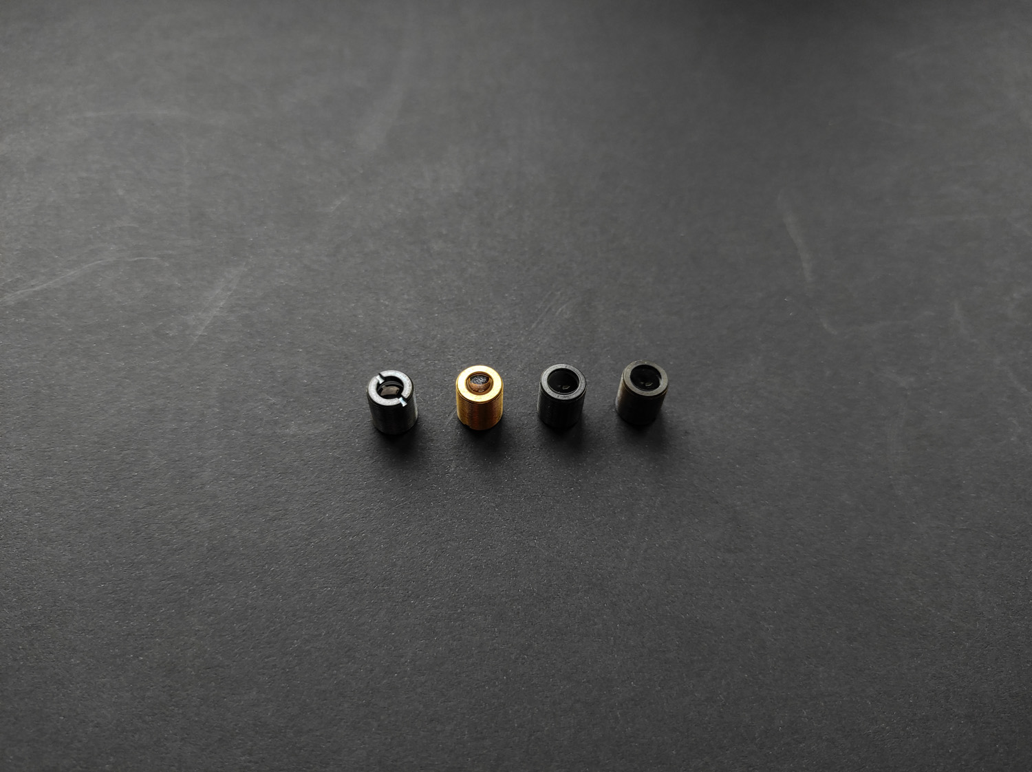

There are 4 common types of diode laser lenses:
  • 3 element
  • G2
  • G7
  • G8
The G8 has these specs:
  • Optimal focal range: 30-100 mm
  • EFL: 8mm
  • NA: .2
  • Best focal range 70-75 mm
  • Smallest laser beam spot: 77 x 130 microns (0.0030315 x 0.00511811")
