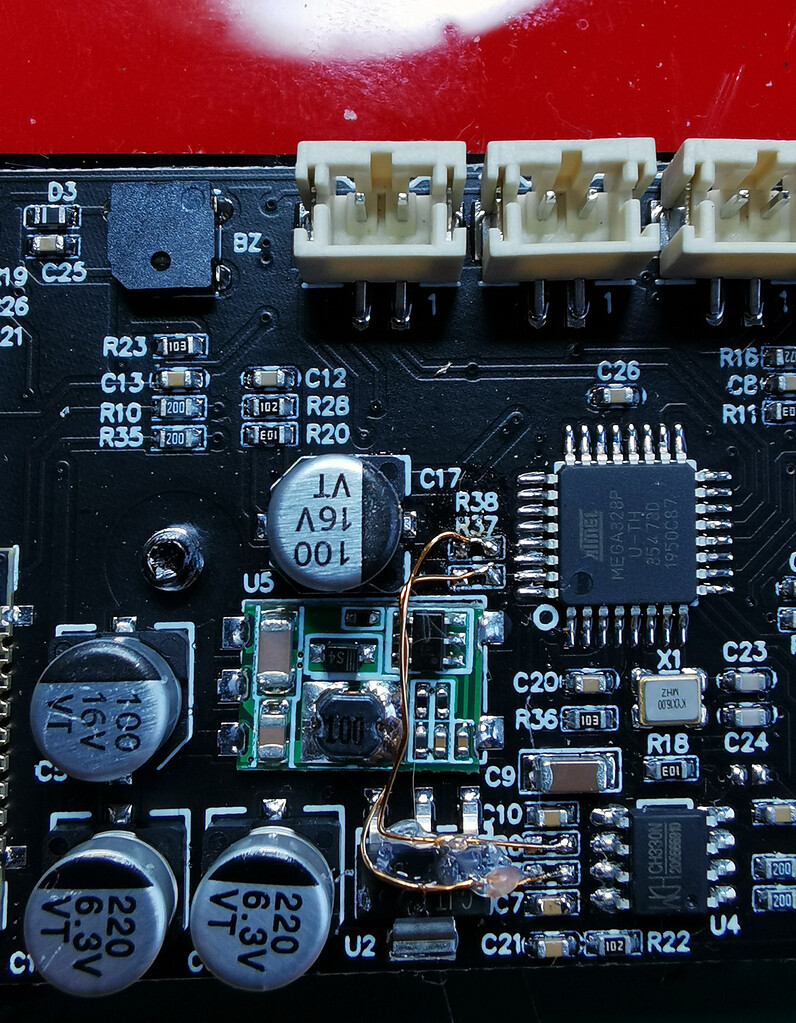

Have you tried this???
Looks like you have to bypass the wifi.
Hi, many thanks. Looks doable but unfortunately I am a bit shaky due to old age setting in, and although I am reasonably competent at soldering I do not feel confident tackling something so small…
