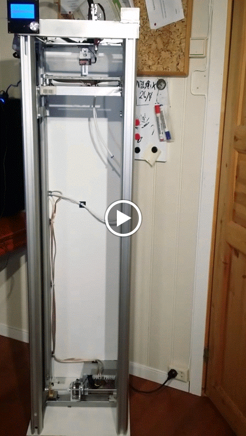

Video of Z axis movement 1300mm.

Do you have a specific purpose for such a long z movement? I use way more x and y travel than I do z.
I was discussing this with a friend and we were curious why you did this approach vs a delta? Because you wanted 4 corner support? Have you tried moving the gantry around? Looks like you’d get some swaying from the top movements.

My other printer have 380x220x280mm build volume and I have often missed more z height.

Delta with 1300 mm z height do not fit in my room.
Goes into David’s question of did you have a specific purpose? There’s typically a reason why you don’t have a very narrow and tall printer like this.
I like it, but I think you’re gonna be top speed limited by swaying.
My Cbot looks to be just about half that height: I recently bolted it directly to the wall. Safe to say there is zero swaying now, solid like rock regardless of speed. But I have the same question: What’s the need for an aspect ration that tall/thin? Seems designed for a specific need?

Have used my old portable printer turned upside down and the aluminum profiles that I found in the trash .Have only spent $ 20 on belts and bearings. That is why .

did you test it for the full height?
Nice! What is the resolution on the Z axis?
590 steps/mm
