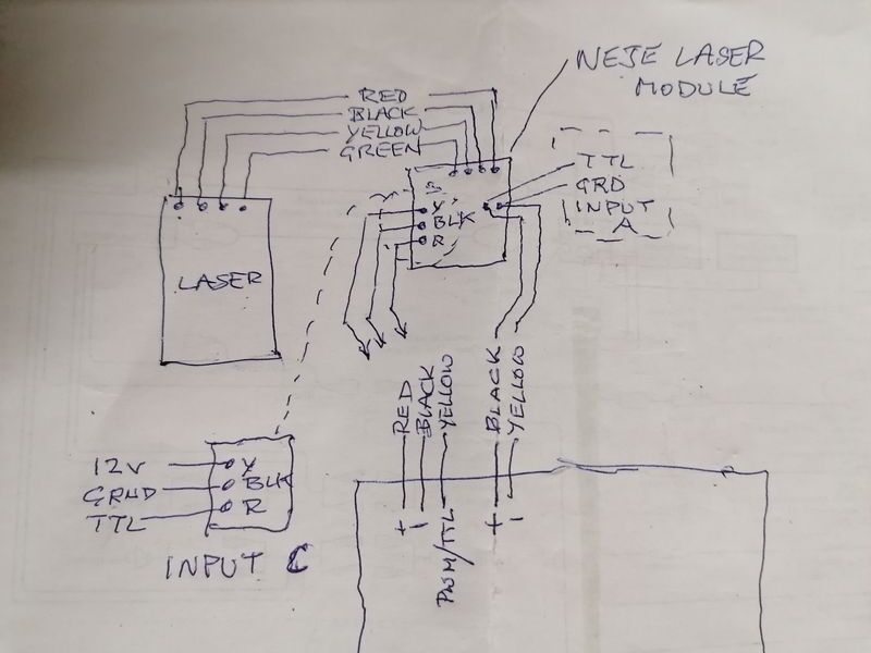

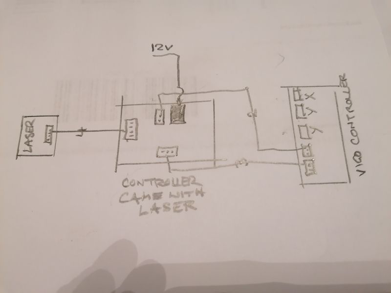

I have no electronics experience, but I have again taken the cover off my VG-L7 (BX20). I feel the problem is with the small control board (Neje laser module) that came with the laser. I have the feeling that the VG controler can go direct to the laser. I have again added some pics with a wiring diagram as it is wired up. The wiring at present will not control the laser at all. only run the motors.
It is the green cable which goes from the small module to the laser, the 3 cores red, yell and black could these go direct and is there a cable that can connect to the green cable.
I dearly hope someone can help me I have had this machine at least 18 months. Probably the best idea would be change the software buy a new controler and try a fresh start. In the meantime I have my fingers crossed that you or some electronic person can help me.

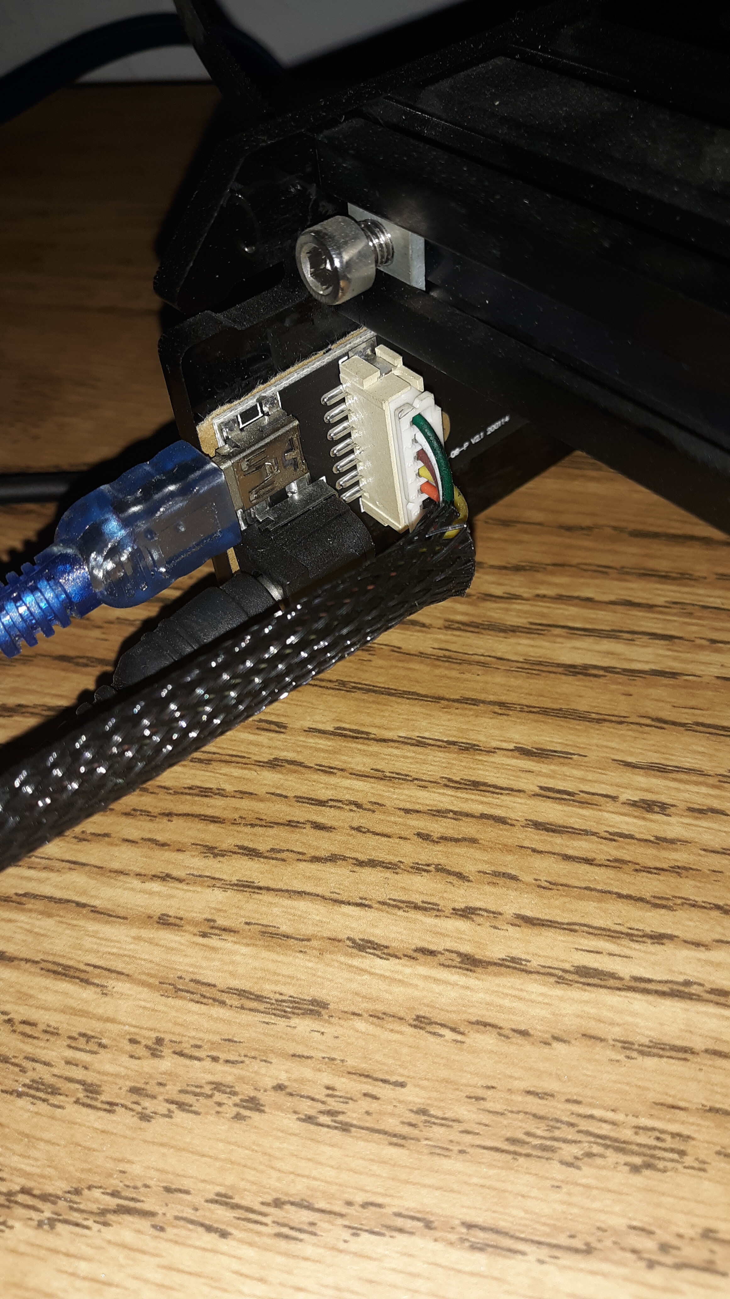

I honestly cannot figure out what would be the issue unless you have something wired wrong, or the firmware is corrupted. I’ve never heard of having to use 2 power supplies unless you have a bad one, or, as I said before, its wired wrong? Also, I’ve found that the machine is picky as to which usb port I use on my laptop. Here are pictures of it being wired correctly.

Thanks Mark for your assumption, I will check this out further, a 3 core cable goes from the controller to the laser which is suppling power, 12v I think cant remember but I tested it. As I said the swiches Laser on and Laser low switch to on or off but do not control the laser. You dont need to opologise, better late than never. Now I can investigate as I didnt know if the 2nd power to laser was needed.
Hello Mark, I have checked the wiring which appears that it can only be wired as it is but I could be wrong.I will attach photos showing the small controller which came with the laser, I had thought maybe I dont need this . But the one problem is the laser has a 4 pole socket. My original controller which I have replaced because the socket for the printer cable broke away as only 2 from the 4 soldered fixings were not soldered. This controller has 2 cables for the laser, 1x 3core and 1x 2core. These 2 cable will not fit to a 4 pole laser connection. That is why I used the controller which came wioth the laser. the 2 cable 2 and 3 pole fit to this small controler and a 4 core cable supplied with the laser goes to the Laser, The laser ich habe is a KKmoon 3500mW / 6000 mW / 7000 mW / 20 W Watt 450nm Blaulicht Laserko photo sketch as wired witth 12v, without 12v nothing happens. Hope you find a solution.
