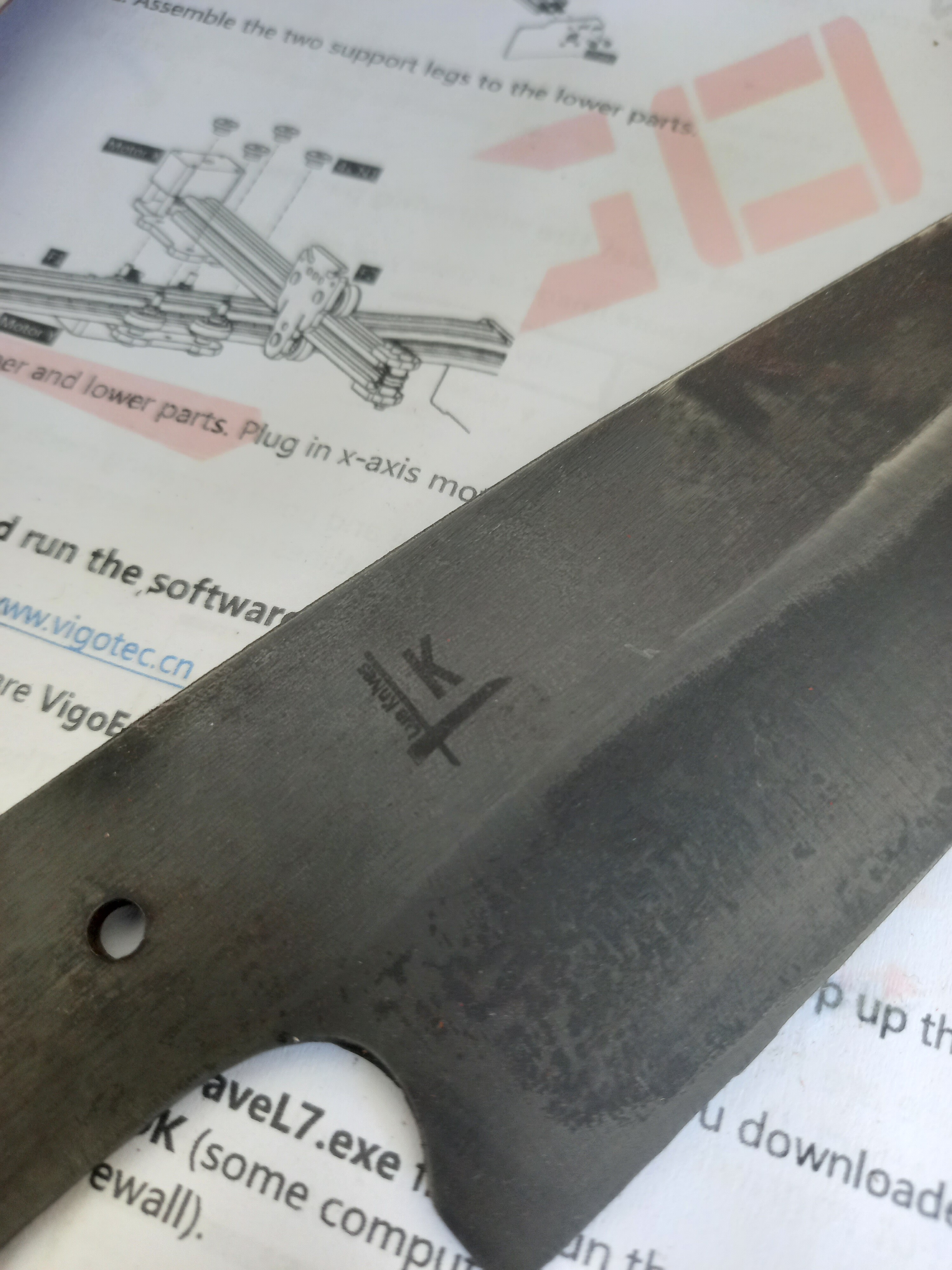

Bonus…
With a small and easy hack it engraves metal!!!
