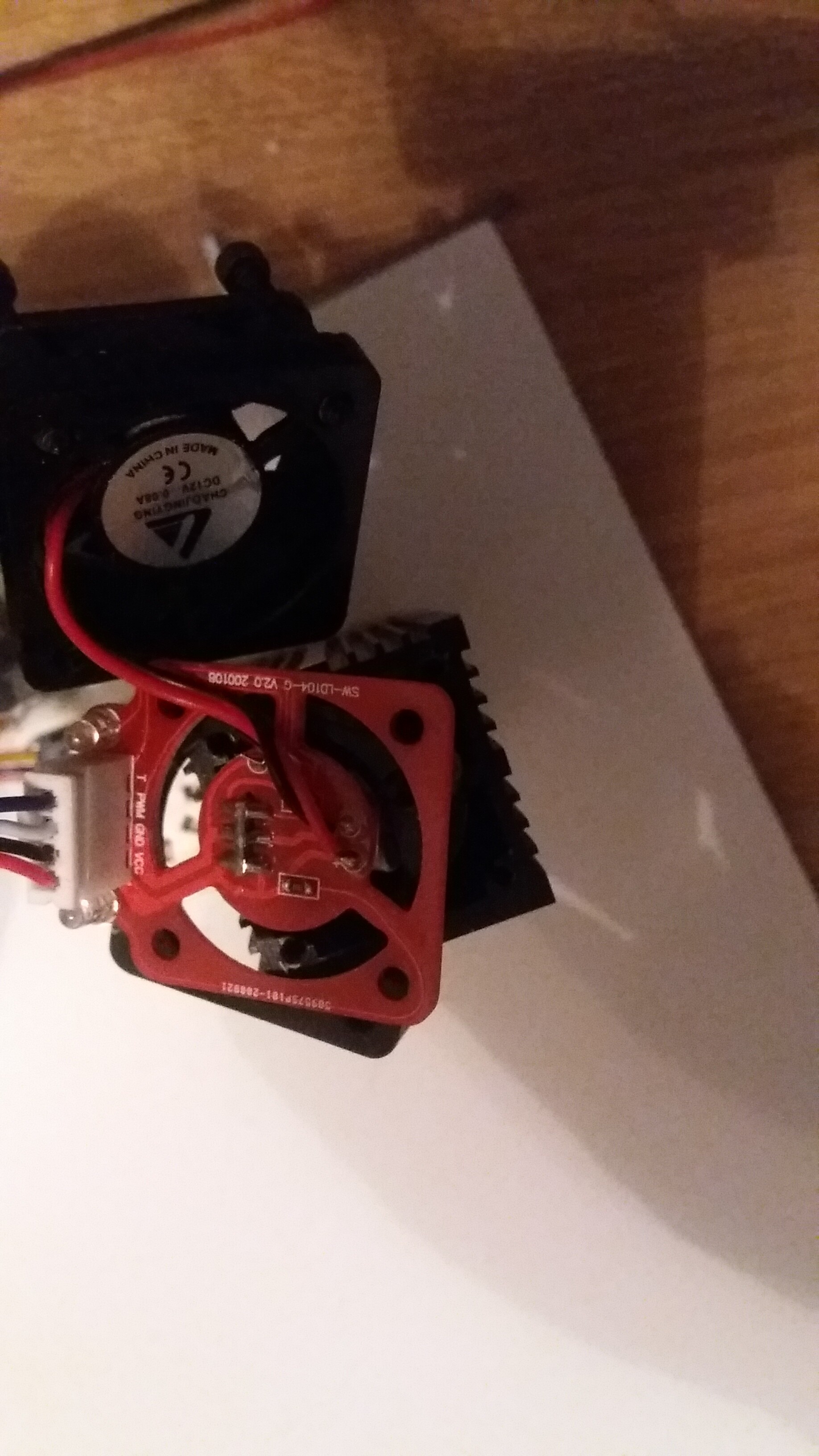

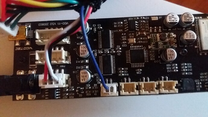

  • Close up of all circuit cards

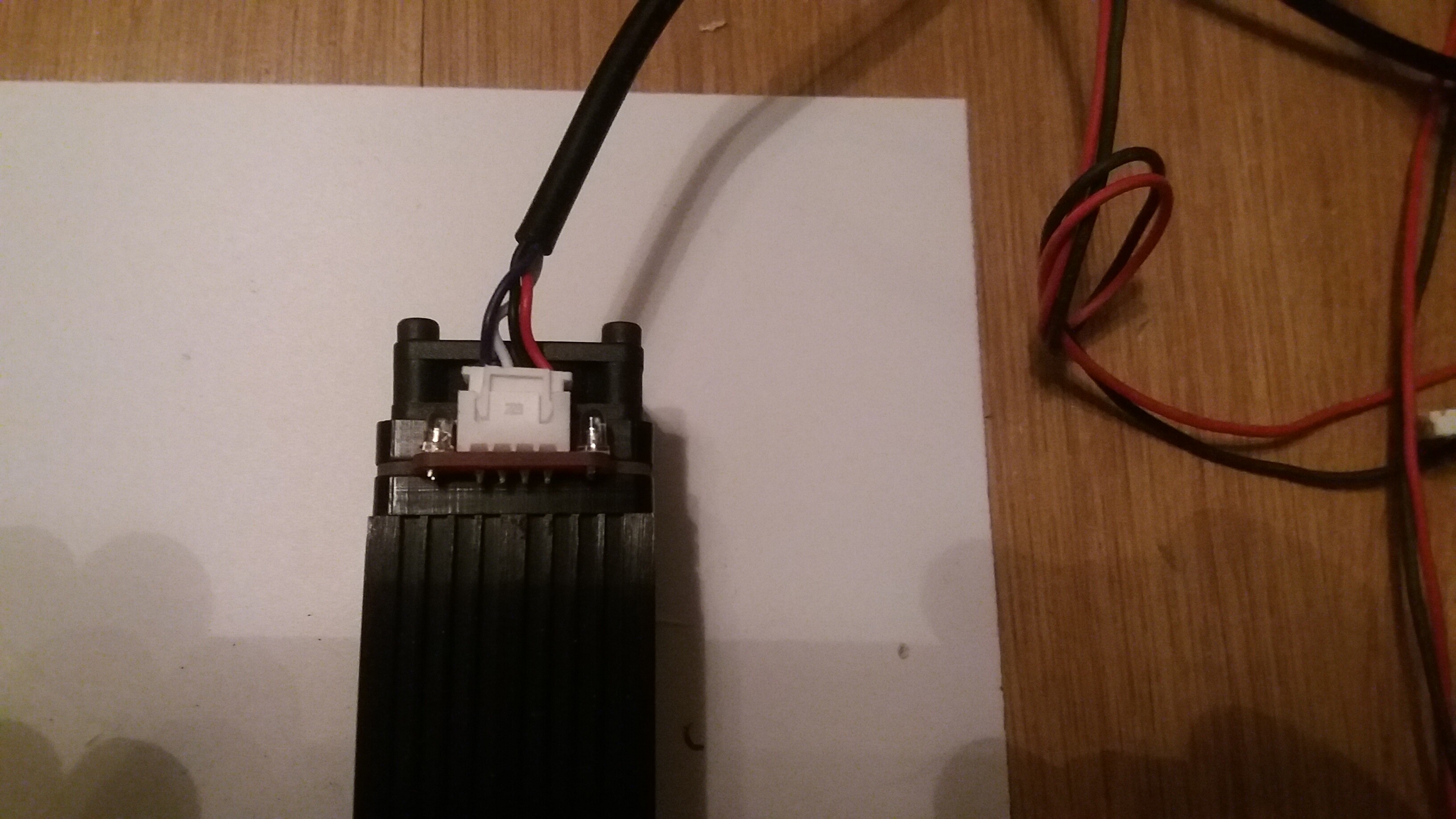

  • Close up of the wiring you are referring to

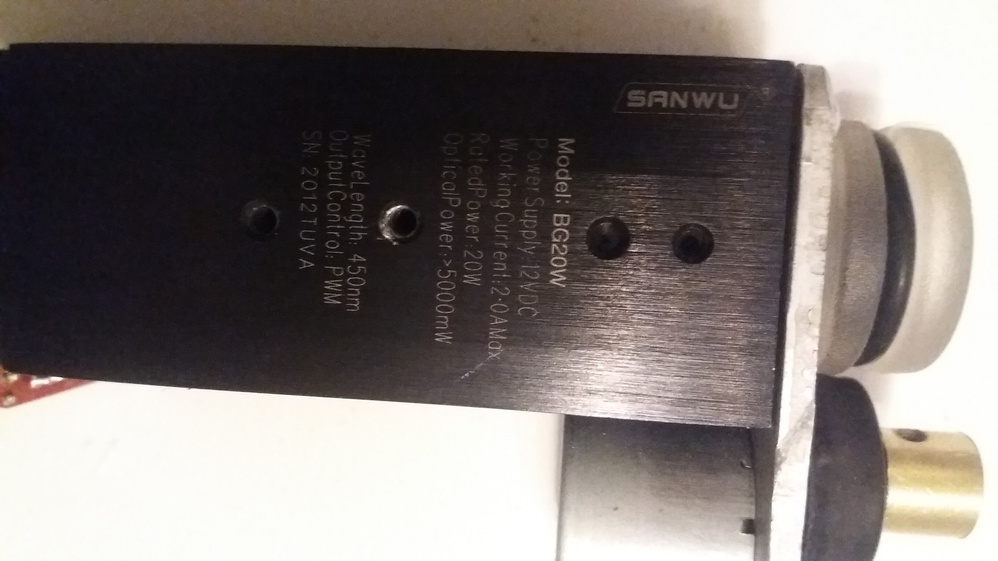

Post pictures of the marking on the laser head
Do you have any specs on the laser head?

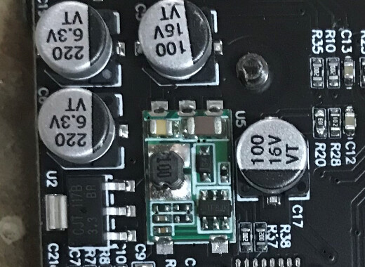

During these final tests, the system came up several times. I was able to connect via wifi. Start weak beam. But could not start the full power. System could not last that long. One of the parts gets very hot on the control board. System givses some alarm beeps and shuts down or gets lost.
The part excessively heating is the one on top right; left of two capacitors, marked U2 or V2.
Uploading: vigoLaserInside.jpg… Uploading: VigoLaserControlBoard.jpg…
If a capacitor is heating up that is another sign of a power problem, usually an overvoltage, reversal or AC on the cap. Measure the voltage across the capacitor, looks like it should be + 5V.
Perhaps your 5V on the card is blown?
T for TEMP!
Following your suggestion I wanted to measure the voltage on the card for the fourth line, and noticed that the plug was labeled as TEMP.
So, all my previous assumptions were wrong. No ground, no TTL. Not even input.
Anyway, I measured it, and it was changing. First it was -1.66. Later it twent up to + 2.3. That is when the system halts itself, due to high temperature.
Voltage across the capacitors are +3.2. and voltage across the U2 unit (not the capacitor, next to it) at its three legs are +3.2, 0.0, -2.3.
Somehow we don’t see a clear +5V, but more or less the half of it. Somehow the +5V is damaged at least.
The system comes up every now and then. The processor ( on the far right, big metal square) heats up as well. I added a huge heat sink (of the 3d printer’s extruder’s sink). It takes a bit longer, but then the system shuts down, or freeze.Not much of a hope on this card.

I would find the 3.3V [most likely] or alternately 5V power regulator and find out what the chip is and how it is wired in.
What is the part # on U2?
CJT 117B?

U2 is the power regulator.
Today I measured more correctly.
If I put the ground on the leftmost leg
left - middle: 3.3 V
left - right: 4.98 V.
middle - right: 1.68 V
I think the pcb is either multilayered or the back is insulated. I can not trace the connections.
laser input port is just next to 12V power input. But of course there is no voltage on +12V of laser if I do not switch the system on.
I can not see any relay switch around.
So finally I found the 5V.
