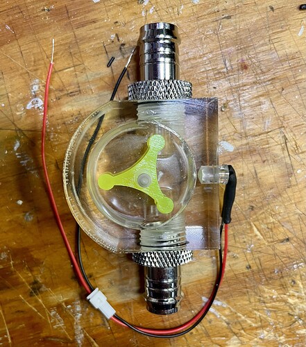

Picked up a couple of PC flow indicators and some G1/4 threaded barb fitting off AliExpress, which was the cheapest option I could find. I picked the yellow spinner to have an option as you will see below.

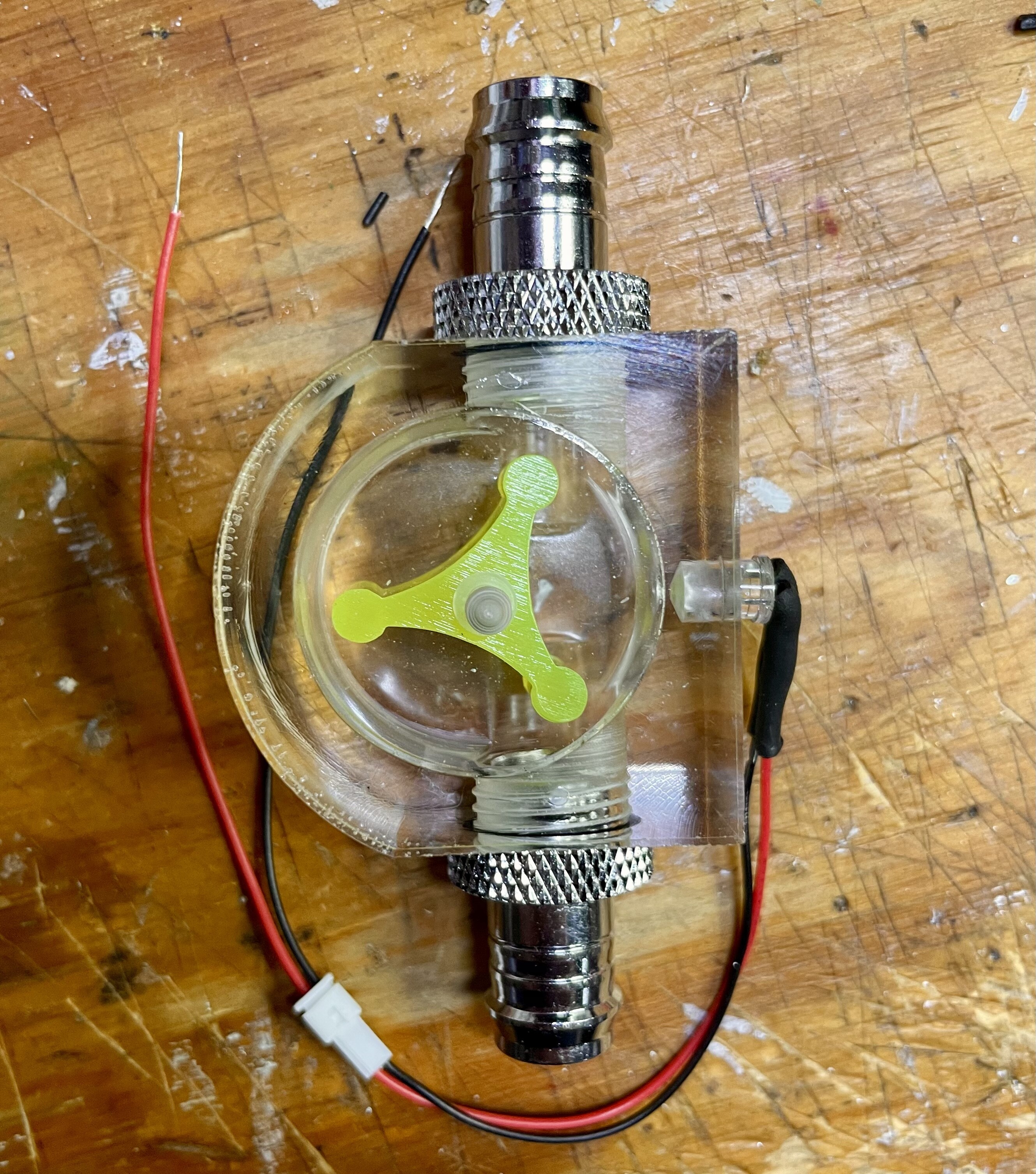

My cooling bucket is underneath the laser and I’m adding the indicator on the return side tubing, just before the bucket. It’s a bit dark underneath, so in order to make it easier to see I’m adding an illuminating LED.
Drilled hole in the bottom, just shy of the cavity, and tacked the LED in with some glue. (The LEDS are 3V, max 24mA and I’m running them from 5V USB ports on my power stirps. So I have a 100 ohm resistor in the circuit to limit the current to the max or below.)

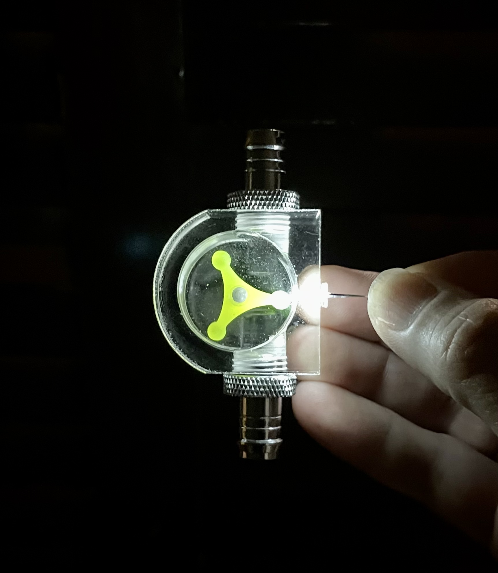

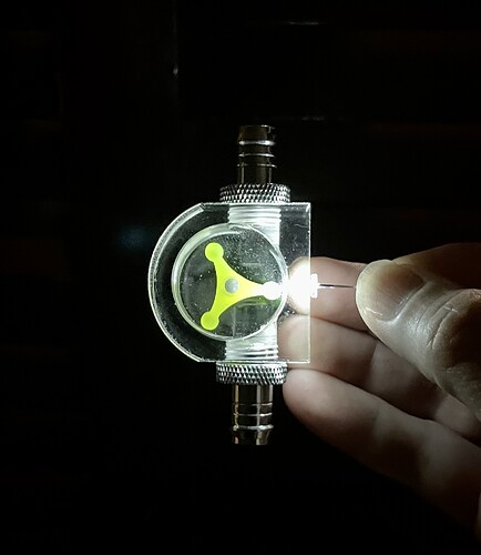

I had two options I considered for illumination. One was a bright white LED

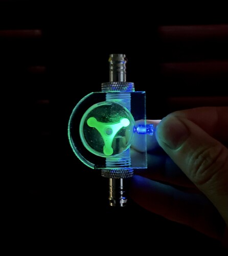

The other was a UV/Purple LED. This is why I selected the yellow spinner as I suspected it contained a fluorescent yellow dye which would fluoresce green under UV light.
Decided to go with the UV LED because it made the spinner easy to see and it looked really cool. :grin:
